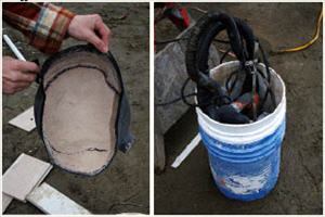

At the end of the day, the carpenter removes and cleans the filter (left), empties the bucket, and stores the filter, clamp, hose, and saw inside (right).
