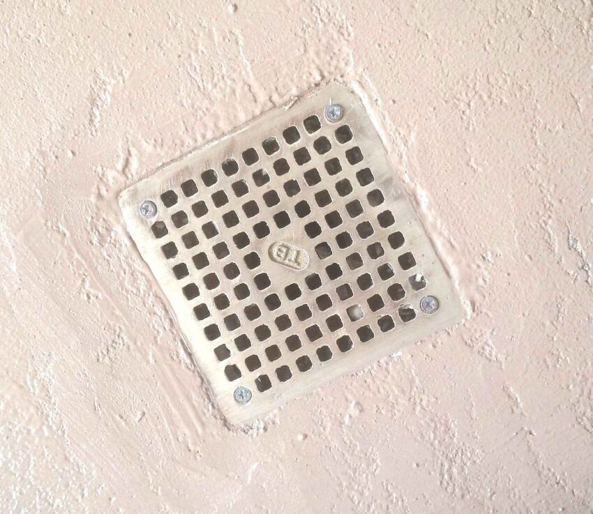

Leaks at drains often occur because the original contractor had used the wrong assembly, such as a toilet closet flange ...
Scuppers and Drains for Waterproof Decks
.. or a plastic shower drain.
We replaced both of those drains with commercial deck-drain assemblies, like the ones from Thunderbird Products. Then we cut and fit metal lath around the flange without allowing the two metals to touch.
We bridge between the flange and lath with glass fiber reinforcing mesh.
When we are satisfied with the preparation and installation of our drains or scuppers, we can then set about installing the rest of the waterproofing system.
