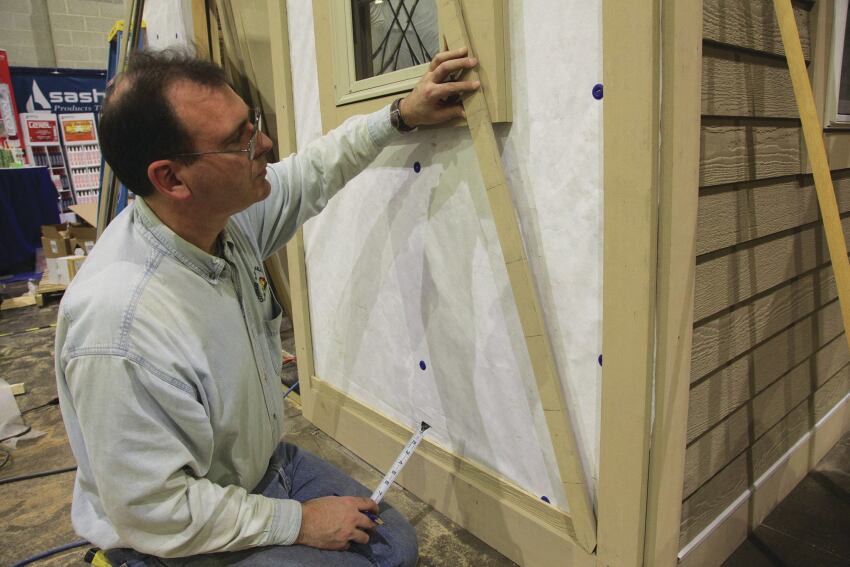

Here are four gauges for installing siding. From left to right: a framing square cut to the siding reveal; a top-mount gauge preset to the size of the overlap; a top-mount adjustable gauge; a bottom-mount adjustable gauge.
Setup & Layout
I lay out the ideal (target) exposure for the courses along my story pole, squaring the lines across the face and onto the edges.
Setup & Layout

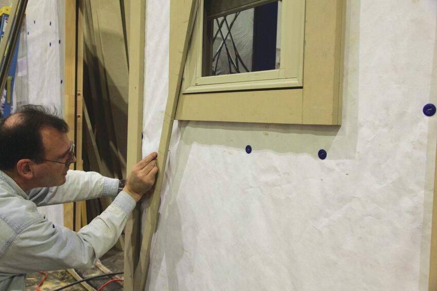

I bring the story pole to one side of an area that I need to divide, and place the bottom of the pole at the level of an element that has already been installed (such as a window sill) or on one of our lower reference lines. I rotate the pole diagonally until one of the story-pole lines intersects with an upper element such as window trim or a reference line.
Setup & Layout
Holding the diagonal story pole in place, I transfer the marks for each course from the pole onto the WRB.
Setup & Layout
I repeat the process for the other side of the area, then connect the marks on the WRB.
