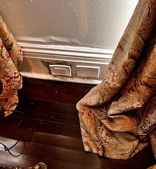

Air leaks carrying humid air that condensed near an outlet damaged wall surfaces.

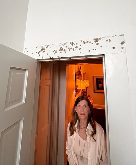

Dark stains above a door signal poor ventilation in a bathroom. The growth is concentrated over the door because the HVAC return in the hallway pulls air though the closed door when occupants are showering.
