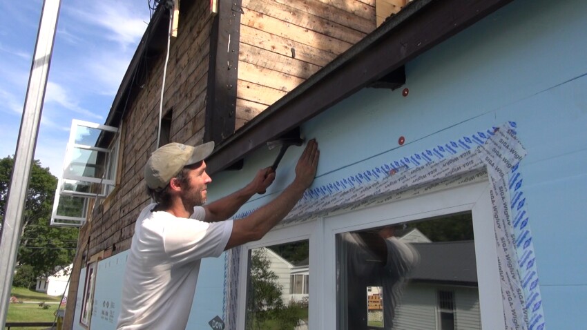

Continuous insulation (CI) is added to the exterior to limit the conductive heat losses through the framing. (photo: Ted Cushman)
