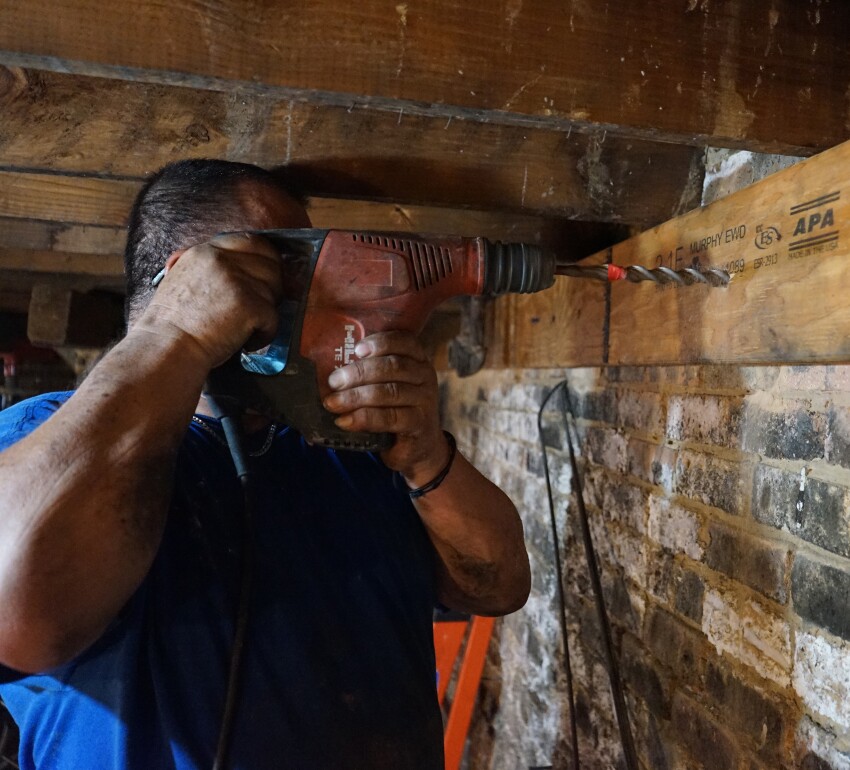

Toby drills through the ledger into the foundation wall to prep for epoxy anchors.
