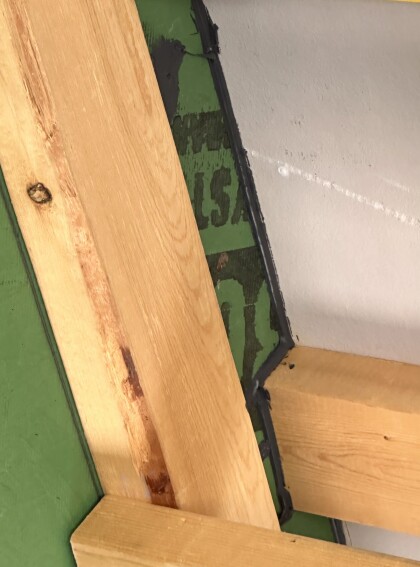

Roof-to-wall seal. For an effective air seal around rafters, the crew cuts the sheathing to fit over the bird blocks between rafters, and the joint between the sheathing and the rafter tails is carefully filled with fluid-applied.

The spaces between outlookers on the rake ends are filled with a bed of fluid-applied sealant.

All roof transitions are also filled with a bed of fluid-applied sealant.
