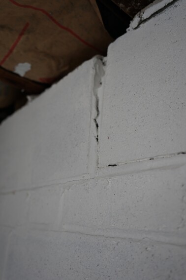

The tell-tale cracks in a CMU wall that has bulged inward from hydrostatic pressure pushing against the foundation from the exterior.
