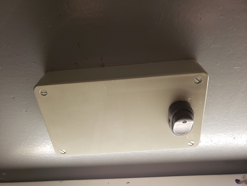

I wired in a bank of 12-volt DC L.E.D. lights so that in a situation where I may need to retrieve something or just work in the trailer without 120-volt power, I have lights available.
Slideshow: Trailer Power Setup
My 12-volt lighting is switched to make getting lights on in the dark even easier.
