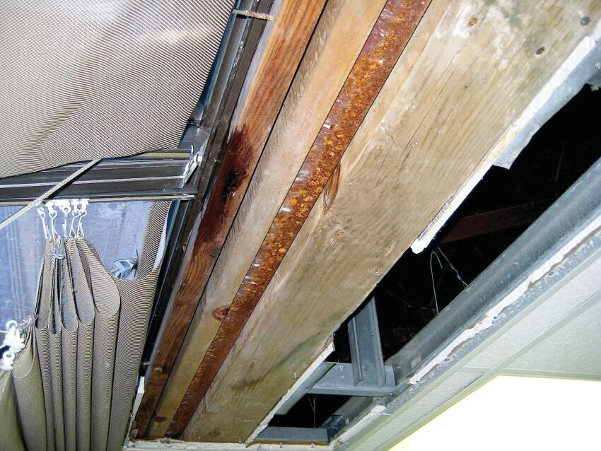

The offices under this curved glass roof had been getting wet for years. The drops of water usually came down days after the rain — not surprising, given the height of the brick wall above, a likely water reservoir. I started with some controlled testing and discovered that water was showing up inside about 10 feet away from an area where I could see a lap in the metal through-wall flashing outside.
Troubleshooting Brick Veneer
Next I called for removal of the drywall ceiling to further narrow the possible entry location. From what I could see inside, I suspected that the laps in the flashing had failed, if they ever worked in the first place. We had no choice but to rent a  bucket truck and — very carefully, considering the glass below — start deconstruction.

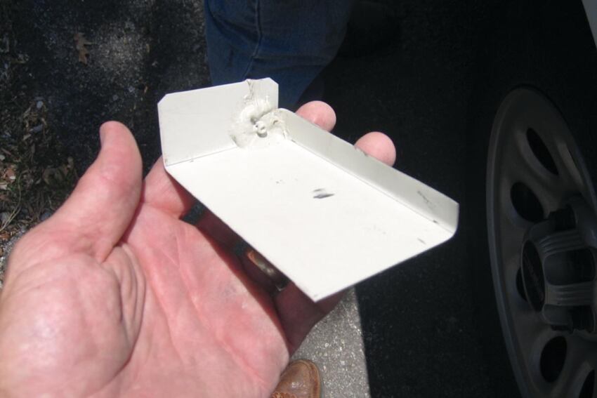

When the roofing contractor did the repair, he soldered the new copper flashings wherever he could, and sealed them with Carlisle’s Water Cut-Off Mastic, a clay-based caulk that effectively stops water as long as it’s in compression and out of direct sunlight.
For good measure, we also added a layer of uncured rubber membrane over the flashing laps. . . .
. . . and at the ends of the flashing. It’s been years now and they’ve not had any leaks since.
