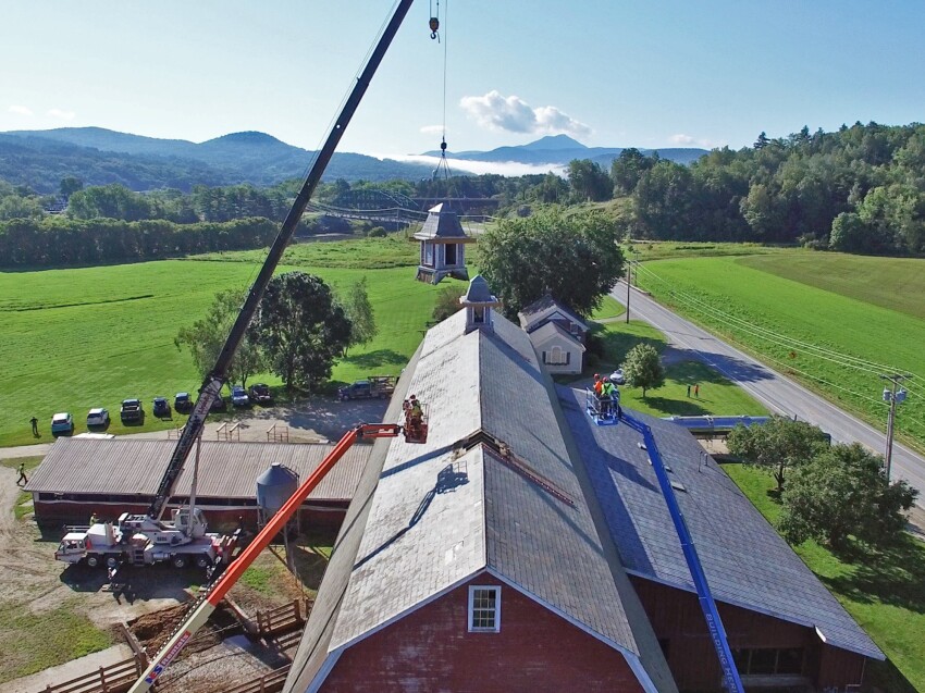

On larger jobs, we’ll bring in a crane and additional aerial lifts as needed. Here, we’re pulling the cupolas off a historic 6th-generation dairy-farm building in Richmond, Vermont. We restored them on the ground, then lifted them back into place a week later.
