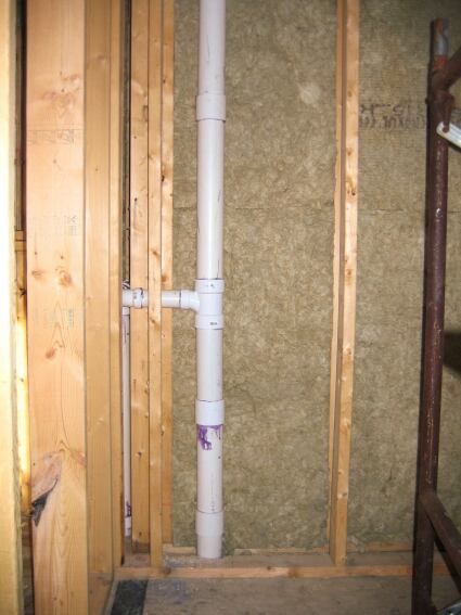

Squeezing any fibrous insulation behind electrical boxes is not a good idea, so we cut around the boxes. For wires, we scored the Roxul and inserted the wires into the grooves. For plumbing pipes, we made a V-groove to accommodate each one ...
Working With Roxul Insulation
... always keeping the pipes to the warm side—the inner wythe of my double-stud wall framing served as a utility wall.
Like any fibrous insulation, Roxul does not stop air, so we were careful to air-seal with rigid board at critical areas, like the band joist, before packing out the wall with Roxul.
