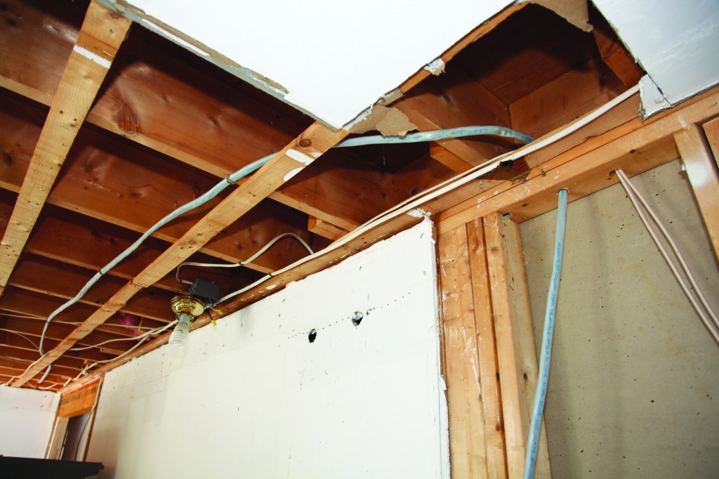

Floor joists resting on the wall plates are a good indicator of a load-bearing wall.

Dealing with a bearing wall. The first step was determining if the pass-through was in a load-bearing wall—I suspected it was. The home was a 1 1/2-story Cape, and the wall with the opening ran through the middle of the house, supporting the floor of the living space above. When I stripped the drywall from the studs, the solid header over the existing opening further confirmed my suspicions. The client had also removed ceiling drywall, in anticipation of a kitchen remodel, and the ceiling joists resting on the wall proved beyond a doubt that I was dealing with a load-bearing wall.
