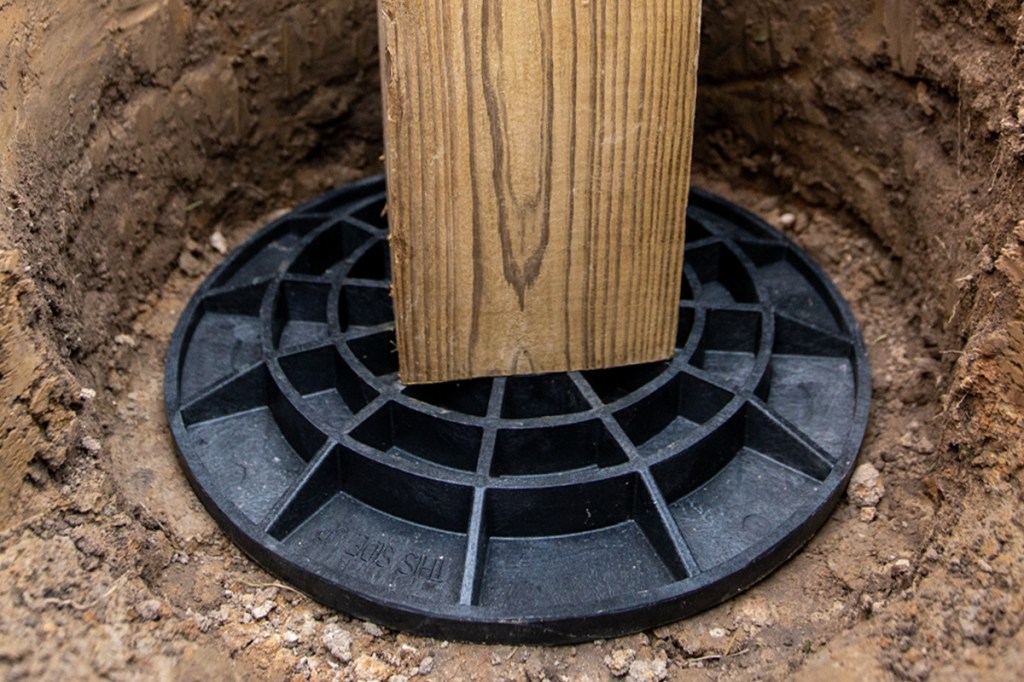

Footings Work by Spreading the Weight of a Structure Over a Larger Surface Area
Because the bottom of a post has a relatively small, concentrated surface area, the structural load on the post can push through the soil, allowing settling and structural damage. Footings function by dispersing the weight on the post over a wider area, thereby reducing the number of pounds per square foot (psf) at any point on the soil surface. By increasing the surface area with a footing, more load can be supported by the same post without settling.

Standard footing sizes have the following surface areas:
DiameterSq. Ft.
10″0.546
12″0.786
16″1.398
20″2.185
24″3.146
For our example, we need a footing surface area of at least 0.7 sq. ft. A 12-inch diameter or larger footing will work. Additional examples and a helpful footing size calculator are available at footingpad.com.

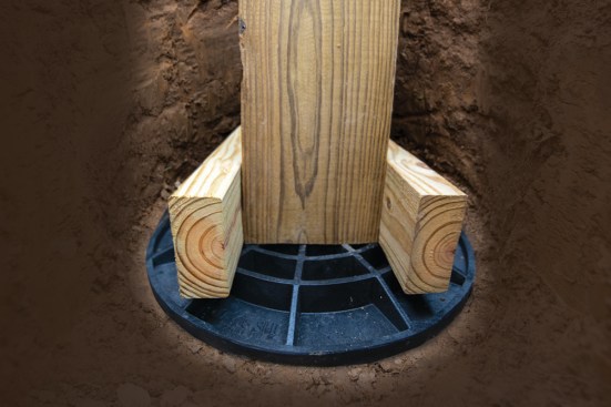

Pro Tip: Metal or wood cleats can be added to posts to provide uplift resistance.
Pro Tip: Use excavated soil as backfill, compacting it every foot. Concrete is unnecessary.
