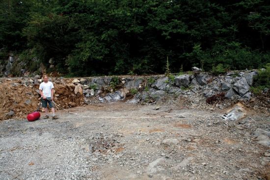

The relatively flat bedrock floor also offered a solid base for a slab foundation. But before I could proceed with the formwork, I was faced with the challenge of removing about 10 cubic feet of limestone in a rear corner of what is now my shop, as well as taking out several ridges that ran through what would become my slab.
The John Deere 710B backhoe couldn’t budge them, so I turned to an approach that my family’s general contracting business has been using successfully for several years: A rock-breaking system called Micro-Blaster, manufactured by a Frankford, W.Va., company called Ezebreak.

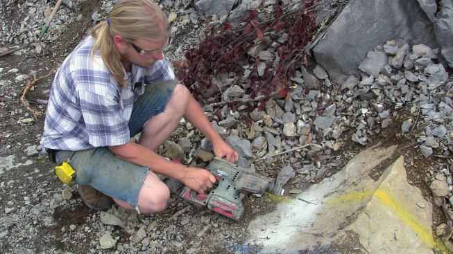

One of the best things about Micro-Blaster is that it requires only a 5/16-inch hole—easily within the capability of an electric rotary hammer with a carbide bit. Where there is no power on site, a gas- or-powered drill will work for this step.
Different types of rock fracture differently, but in general it’s best to drill at a fairly shallow angle, with the goal of breaking loose a 6- or 8-inch–thick section of rock with each charge. It’s important to drill the hole to the proper depth—a single charge requires a 10-inch–deep hole. If the hole is too deep, the firing pin won’t be able to engage the cartridge.

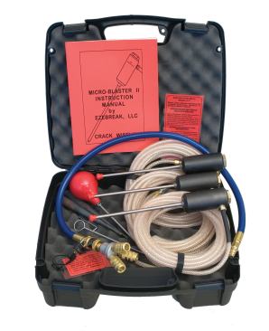

For smaller jobs, we sometimes use our original Micro-Blaster, a single-head version that is activated with a 25-foot pull cord, but we mainly use the newer Micro-Blaster IIx3 kit, which has three separate heads that can be detonated separately or simultaneously.
Rather than relying on a pull cord, though, the three-head version is activated by compressed air supplied to the heads through three 25-foot lengths of 1/8-inch air hose—a smaller-diameter version of the hose used to power pneumatic nailers. The individual hoses connect to a three-way quick coupler that incorporates a key-operated lockout valve. A short length of hose from the valve is coupled to an air compressor or a portable air tank.

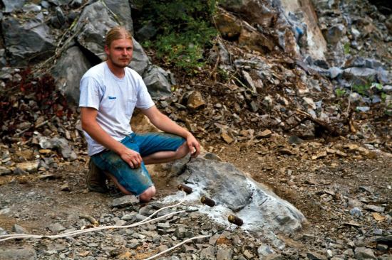

Once hoses are connected and the area is secure, unlocking and opening the valve activates the firing pins and fires the charges. When three charges are ready to fire, you have the option of setting them off individually by connecting only one of the hoses to the valve at a time. In general, though, I find that it’s best to fire all three at once, since that seems to provide the most breaking power. A portable 10-gallon tank like the one I used on this project holds at least enough air for several dozen shots before it needs a refill.

The explosive in the Micro-Blaster cartridges is active only at high pressures. Once the charge fractures the rock surrounding it, the pressure is relieved and the explosive reaction essentially comes to a stop. As a result, there’s not a lot of surplus energy to fling rock around. Setting off a charge from 25 feet away—the length of the air hoses—feels perfectly safe. I’ve occasionally seen golf-ball size rocks travel 10 or 15 feet, but with no more velocity than you’d get from a gentle underhand toss. If there are vehicles close by or we are working close to a house, we will drape a section of old household carpet over the area to prevent any damage.
Although it seems counterintuitive, hard rock such as limestone usually fractures more easily than sandstone or other softer materials. Depending on the rock and how much fracturing you want, you can insert as many as four cartridges in each hole. The secret is to find the minimum number that will give you a satisfactory result. Multi-cartridge shots require you to drill 2 inches deeper for each additional cartridge, which means more time and more wear and tear on bit, drill, and operator. Cartridges themselves cost about $2 apiece, which also adds up over time.
