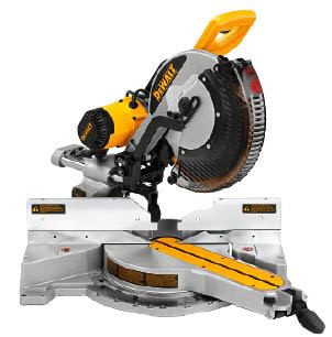

DW718 Double-Bevel Sliding Compound Miter Saw DeWalt
800/433-9258
www.dewalt.com
Street price: $650
Deck building is commonly circular-saw territory, but a 12-inch slide compound miter saw is unbeatable for blasting out blocking, cutting 2x2s, plowing through 4-by stock, and doing a zillion other things. And for porches — think beaded ceiling material and crown — a miter saw is a must. I use a DeWalt DW718. DeWalt nailed this tool: Its power, accuracy, and multiple features combine to help deliver quality work quickly.
The DW718 has power — it muscled through 2x10, 2x12, and 4x6 TimberSil Wood, a treated lumber that's about the hardest material I've encountered when building decks. And cutting cedar and yellow pine is a cinch. The top-mounted belt-drive motor does hop some on start-up (all the belt-drive saws I've used hop), but the hop is so subtle I don't notice it anymore.
The blade brake on this saw is a great feature. The rapid slowdown in the blade rotation means I can draw the tool out of the work more safely and quickly. It cuts down on the ear-aching noise that a whirring blade and motor apparatus create while freewheeling after a cut. And because the blade slows itself, I don't have to take the extra step of pressing the waste piece into the blade plate to stop the blade — a common practice — which means I can be working, not fiddling with the saw.
Right out of the box, the saw cut square and true. It's easy to swing to any angle. The detents lock positively, but in spite of this feature, setting an angle just past a detent is a snap. The bevel detent system has both right and left detents at 33.9 degrees for cutting crown flat, and the adjustment lever is top drawer. The lines of site are great — I could see the blade teeth hit the work through the louvered guard and by sighting along the blade.
Handle orientation is one of those Ford vs. Chevy things with carpenters; but for my hands, the DeWalt's two-finger trigger has perfect spring tension and is the perfect size. There are no pinch points or infuriating trig­ger locks. The carry handle is smartly posi­tioned on the top of the saw and is beefy enough to get a solid grip on, making this saw easier to lug between truck and site than other saws I've lugged. At 53 pounds, it's comparatively light.
As for capacity, the DW718 can handle most of the cuts a deck builder re­quires. It miters 2x10s at 45 degrees and cuts 4x6s either flat or on edge in a single pass. The 45/8-inch-tall adjustable fence enables me to cut tall crowns (up to 65/8 inches) nested without setting up a sacrificial fence.
Access to the blade is simple and intuitive — much better than most others I've used where you have to disassemble half the saw guard to access the blade bolt. And DeWalt includes an awesome blade wrench that stays in its on-board location. Once loosened, the blade comes off easily.
As good as it is, the saw could be better. The dust collection port is small, and it broke when a hunk of wood ejected into it — though it actually works a little better now. The included blade wasn't great, so I upgraded to a better one for trim and used a construction blade for framing, with more success. I also wish there were a grommet to hold the cord completely free of the slide rails. It can pinch in there sometimes.
