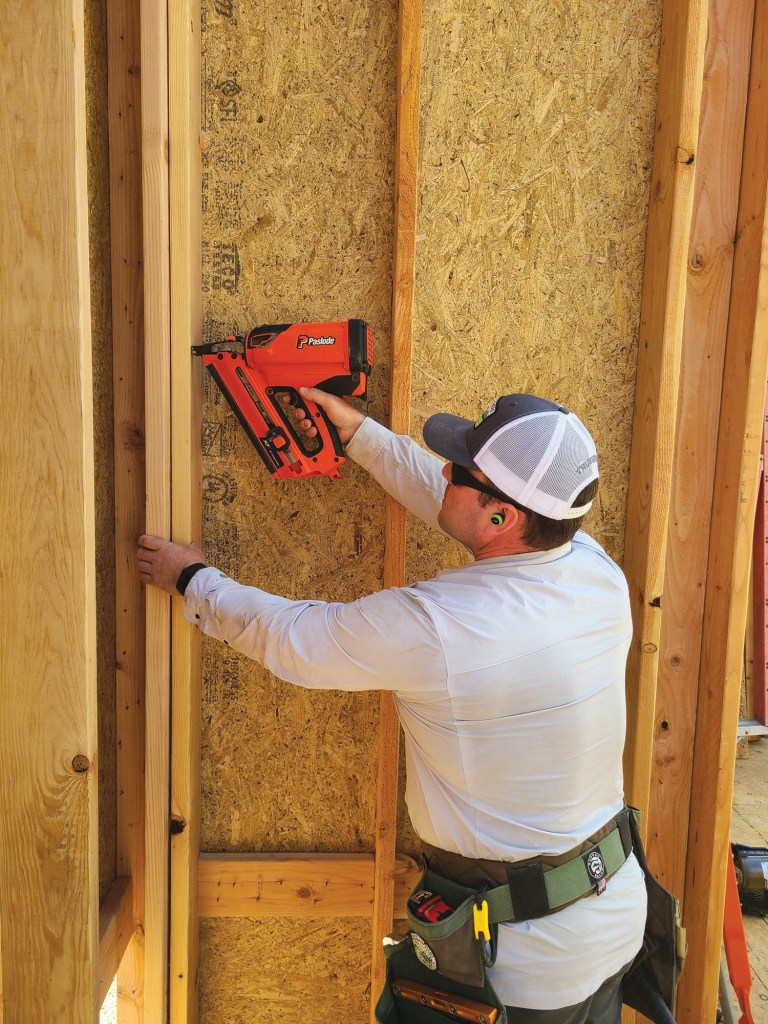

When I reviewed the XP nailer for Tools of the Trade in 2015 (see “Field Tested: Paslode’s Cordless XP Framing Nailer”), I gave it excellent marks because of how well it performed. In our testing then, we shot through three boxes of nails and two gas canisters without a single jam or misfire and had no trouble shooting into LVLs. For blocking and pickup work, the gun was plenty fast, and the aggressive nosepiece made it easy to toenail accurately. The latest version of the XP shares all of these characteristics.
So what’s new? Before sitting down to write this review, I compared the 2015 model with the 2021 model, and the only significant difference in operation I found is that I can load the magazine before pulling back the slide. But I’m not irritated at all to be reviewing a gun that is nearly identical to the gun I reviewed six years ago. That just means Paslode got it right then and has now made a great gun a little better.

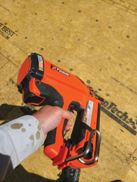

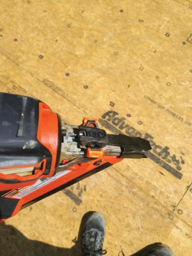

Paslode’s cordless CFN325XP framing nailer is light at 7.2 pounds and compact enough to easily fit inside framing bays, making it ideal for installing blocking and other pickup work. It has an aggressive nosepiece that prevents the nailer from slipping when toenailing, and tool-free depth-of-drive adjustment.
Since this gun is gas powered, it requires fuel and a spark, but the tiny, 7-volt lithium-ion battery is very light, as are the gas canisters, which are widely available. Paslode claims that a canister of gas will shoot up to 1,200 nails, and that a battery will last 9,000 nails. What I found is that I never ran out of fuel before I used up the nails in a box and canister combo.
Performance. It is true some battery-powered nailers are very fast. Paslode claims this gun (sequential trigger only) shoots three nails per second. I don’t care what the actual number is; it shoots as fast as I nail, which is good enough for me.

The Paslode XP nailer has a big rafter hook that rotates so that the nailer can also be hung from a tool belt.
Weight. Even when loaded with a strip of nails, the gun weighs in at right around the 7-pound-6-ounce mark—about 4 pounds less than comparable battery-powered nailers on the market. That matters because when I hang the gun from my bags, I’m not lopsided. It means when I frame overhead, I cause less wear and tear on my shoulders, and the list goes on. And the recoil is light, so there’s little shock to my wrist when I use it.
This is important to me; I’m nearly 44 years old and have always worked in the trades, specifically framing, foundations, and siding. Choosing tools with a view to staying healthy cannot be oversold. I love this gun and recommend it.
