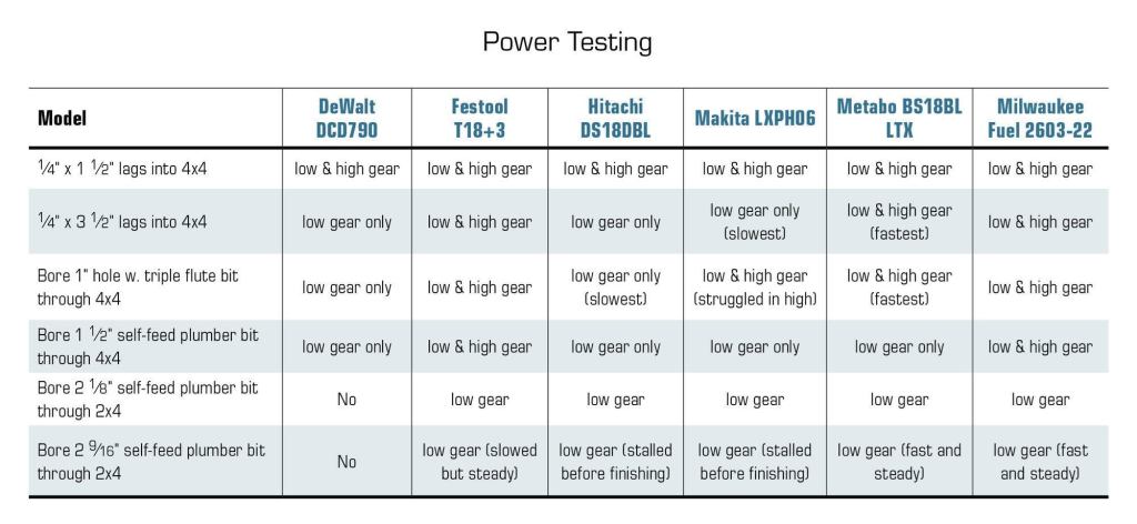

Power

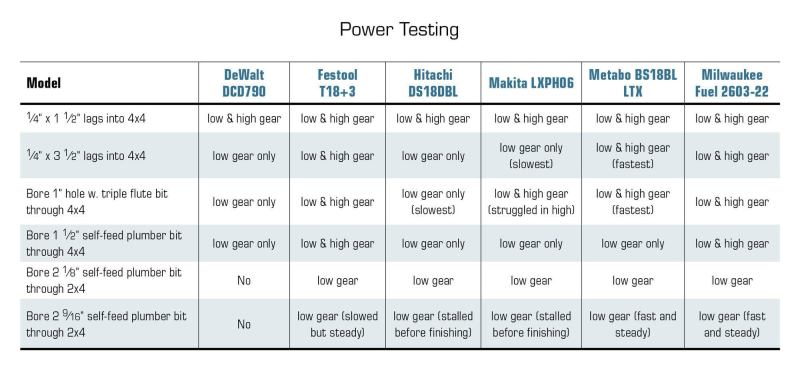

To test the limits of these tools’ power, I used them to perform progressively more difficult drilling and driving tasks in both high and low gear (see table, facing page). The tougher tasks were more challenging than what you would normally expect an 18-volt cordless drill/driver to be able to do.

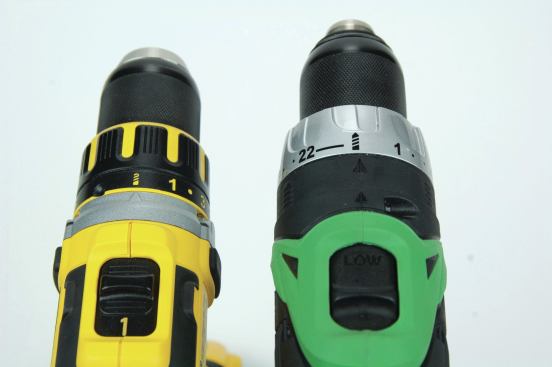

Optical trigger. Hitachi uses an optical trigger that is said to be more durable and provide smoother speed transition than traditional mechanical ones.
Speed control. As with other models, high and low gear are controlled by a mechanical slide switch, but Hitachi added an electronic control that limits max rpm to four steps within each gear. This feature makes more sense on its brushless impact driver; with a drill, it’s simpler to reduce speed by feathering the trigger or using low gear.

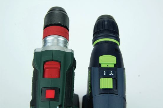

Electronic clutch. Most drill/drivers have friction clutches, which give way at a certain level of resistance. The Festool and Metabo tools, however, have electronic clutches that are coupled to the trigger. Instead of disengaging the chuck from the still-spinning motor, they immediately stop the motor. These electronic clutches are very precise—a little too precise for driving in wood. A friction clutch will still drive fasteners the last little bit while slipping, but electronic clutches are more abrupt; they stop and start at a particular torque and there’s no outsmarting them. As a result, when working in wood, I tend to leave them at the highest setting or in drill mode.

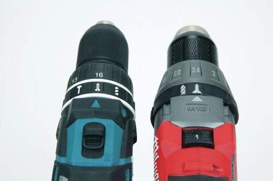

Mode switch. The usual arrangement for a drill/driver is for it to have a drill-mode setting at the high end of the clutch ring. Makita and Milwaukee equipped their tools with separate mechanical mode-changing rings. Besides being quicker, this allows you to switch between drilling and driving without changing clutch settings. Festool and Metabo rely on electronics to bypass the clutch—a switch on the former and a push-button on the latter.
For years, Metabo has offered what it calls the “impuls” pulse mode. When you hold the trigger down in this mode, the tool rapidly cycles on and off like a slow impact driver. I don’t find much use for this feature in my work, but the action is supposed to help when you’re starting drill bits in metal or backing out screws with stripped heads.

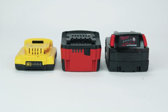

As recently as last year, the average cordless system topped out at 3.0 Ah for full-size packs and 1.5 Ah for compact ones. For most tools, the current maximum for these sizes is 4.0 Ah and 2.0 Ah respectively. Metabo is premiering a full-size pack with a 5.2 Ah rating—an astounding number and the highest we have seen to date in an 18-volt tool.

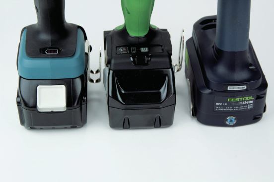

Battery Fuel Gauges
It was a long time coming, but this is the first test I have done where every model had a fuel gauge. As with cellphones, more bars mean better service. I prefer the distinct accuracy of battery gauges with four bars (Metabo, Milwaukee) over those with three bars (DeWalt, Festool, Makita) and especially over the uncertainty of a two-bar gauge (Hitachi).
It’s nice to have a little bit of juice left when the battery shuts down at the end of the charge. That way, you can restart the tool and finish removing a fastener or reverse an auger bit out of a hole without changing batteries. This is not the case with the Milwaukee, which drains every allowable milliwatt out of its battery and then leaves you instantly immobilized. The Makita also occasionally does this.

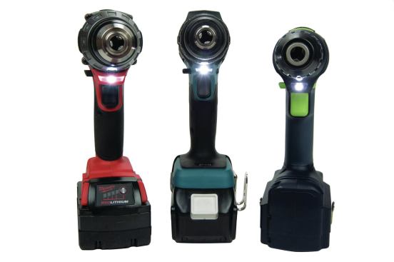

LED Headlights

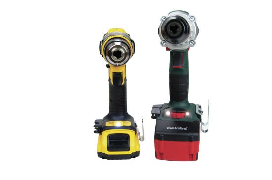

Festool, Makita, and Milwaukee put their lights in the usual place—just above the trigger. On the DeWalt and Metabo, the light’s on top of the tool base where it will not be eclipsed by the chuck. Because of its low angle, the DeWalt’s LED does the best job lighting the head of a screw or tip of a drill bit. The twin lights on the base of the Metabo are a good idea but they’re aimed so far out that unless you’re using a really long bit, they’re worthless except as a flashlight.
There are spaces molded into the base of the Hitachi for a switch and light. Its brushless hammer drill/driver contains those items, but for some reason this drill/driver does not.
Belt Hook
Belt hooks are standard issue with most drill/drivers. Of the tools tested, only the Milwaukee does not come with a belt hook. You can get one as an accessory but it requires a troublesome special order.
Most belt hooks consist of a large steel hoop that can attach to either side of the base alongside the battery. Festool attaches a double-sided hook to each battery, but the hook’s small size and plastic attachment tab make me question its long-term durability.

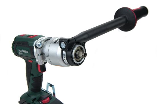

It helps to have a removable side handle when you’re drilling large holes or driving lags, because you want a good two-handed grip. This will not only protect your wrist; it may also prevent you from getting hit in the jaw with the butt end of a drill. The Hitachi, Metabo, and Milwaukee include side handles; the others do not.

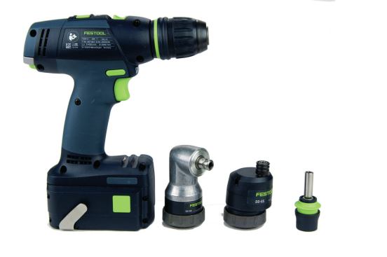

Festool T18+3
Includes: Two batteries; charger; Centrotec bit holder, offset bit holder, right-angle bit holder/chuck mount, Systainer case. Less expensive drill kit available without accessory attachments.
Comments: Surprisingly strong tool with versatile attachments, but at quite a price
Pro: A mid-size tool that performed in the stronger half of the testing despite brand’s reputation for refined woodworking shop tools. Even displayed great power in high gear. Chuck detaches easily without tools to allow the drill/driver to fit other attachments. The accessory ends in the kit tested provide a lot of versatility. Forward-thinking battery compatibility with all 18-, 15.6-, 14.4-, and 12-volt batteries from the brand.
Con: Very expensive compared to the competition. Exacting electronic clutch fussy to use. Belt hook not large and robust enough.

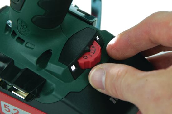

Metabo BS18LTXBL Quick
Includes: Two batteries; charger; side handle, plastic case
Comments: Powerful, fast, exotic, and expensive, but with a few perplexing features
Pro: Very high power, the fastest in most of the trials, and the highest amp-hour cells we’ve ever tested provide the longest runtime. The unique pulse mode can aid in metal drilling and powering out stuck or stripped screws. Changing the electronic clutch setting automatically switches the tool to driver mode. Cool, high-tech innovations, like a motion-activated headlight that stays on as long as the tool is moving and a motor brake that returns electrical energy back into the battery. Chuck detaches easily without tools to allow unit to fit optional attachments. Side handle comes in handy for high-torque work.
Con: Exacting electronic clutch fussy to use. The center of the headlight is set to align with the tip of an 8-inch bit so it misses the mark for most common uses. The headlight’s motion sensor is too sensitive—goes on with the slightest bump near the unit, which is distracting.
