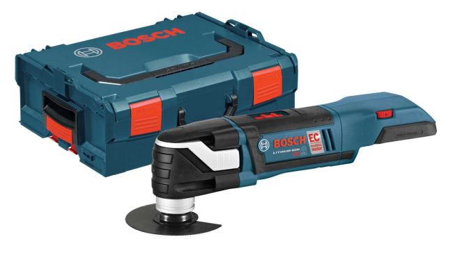

In September when JLC asked if I’d like to field-test the new Bosch brushless model MXH180 18V Multi-X oscillating tool, I didn’t hesitate to accept. It’s one of several 18-volt models on the market that promise to perform like a corded model, and I couldn’t wait to see if its cordless convenience would make a big difference on the jobsite.
Clean Kit
The 18V Multi-X is sold only as part of the MXH180BL kit. The user-friendly kit includes a modular L-Boxx-2 case that, for easy storage and transport, can be stacked with and locked to other L-Boxx cases and components in Bosch’s Click & Go line. Inside the case, an Exact-Fit tray conveniently holds the tool with the battery and an accessory installed, houses two extra batteries and a charger, and even provides a dedicated space for the charger cord (thank you). The case also contains a removable plastic box that stores and organizes your accessories—a welcome feature that keeps everything neat and accessible.

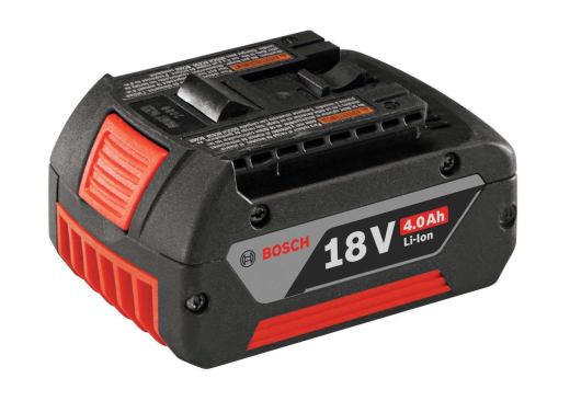

The batteries and charger are sold separately. If you’ve already bought into Bosch’s 18V lithium-ion platform, you’re good to go. I haven’t, so Bosch also sent me its SKC181-101 lithium-ion starter kit ($100), which includes a 4 amp–hour battery and a charger. The tool also accommodates Bosch’s compact 2 amp–hour battery and older batteries in the platform, but Bosch recommends using the 4 amp–hour battery for remodeling because it is more powerful and delivers the longest runtime.
Quick-Swap Accessories
Until recently, most oscillating tools required the use of an Allen wrench to swap accessories. The MXH180 lets you swap them at the flip of a lever, which is a blessing. Bosch makes a wide range of cutting, grinding, sanding, and scraping accessories, all of which mount to the tool using the company’s 12-pin Oscillating Interface System (OIS). This interface prevents the accessories from slipping and allows you to orient them in 12 different positions for optimal access and maneuverability.
I tried several of these accessories with good results. I love the slight curvature of the OSC114F wood-metal blade, for instance, because it makes plunge-cutting and cutting into corners much easier. Also, Bosch’s plunge-cut blades have a helpful depth scale along one edge. (Other manufacturers, including Fein, also make some accessories that fit this tool.)

Through all of this work, the tool was at least as powerful as my corded models, and the 4 amp–hour battery had plenty of runtime to complete each job. A fuel gauge on the battery indicates when its is time to recharge.
Runtime can vary dramatically, of course, depending on the workload. For what it’s worth, when we fully charged the battery, mounted the Bosch OSC312F wood-metal blade that was included with the tool, and let the tool run full-throttle at room temperature until the battery quit, it ran for 41 minutes and 27 seconds. After that exercise, the Bosch’s metal gear housing was too hot to touch, but that probably helped dissipate heat—the battery was only slightly warm.
