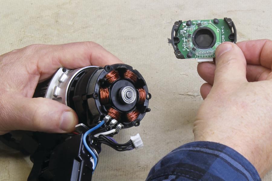

Electronic commutation. A brushless motor — also called an electronically commutated (EC) motor — is essentially a permanent-magnet motor turned inside-out; it has electromagnetic windings on the stator and permanent magnets in the rotor. The magnets require no power, so there is no need for brushes and a commutator.
Since it lacks the mechanical switching provided by a rotating commutator, a brushless motor enlists a microprocessor (a tiny onboard computer) to provide electronic switching in a process called electronic commutation. The position of the rotor is monitored by the electronics, which time the electrical pulses to the electromagnets in the rotor, thereby controlling the direction and speed of the motor.

A brushless motor is like a permanent-magnet motor turned inside-out; it has windings on the stator and permanent magnets on the rotor. Brushes are not required because the rotor consumes no power.
Because it lacks brushes and a commutator, a brushless motor must be electronically commutated. A controller senses the position of the rotor and relays that information to the microprocessor that regulates the tool.
