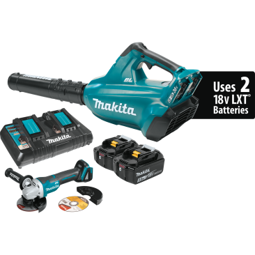

Makita 18v X2 36v Brushless Blower. Makita has a line of 2 battery 36v tools and so far they have been impressive to use. This brushless blower has plenty of power for our use delivering 473 CFM at 120 mph. On the handle is a 6-stage dial to adjust and then lock in speed.
I found this blower to be well-balanced and though my sound meter app showed it only slightly less loud than the Milwaukee and DeWalt, it seemed much quieter. I don’t know how to account for that and frankly it doesn’t matter since I am religious about hearing protection.
Runtime at full speed was only 11 minutes. It’ll still last the day for us, though. I found this kit online for $329.

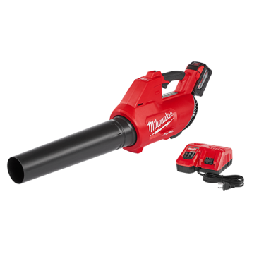

Milwaukee M18 Fuel Blower Kit. This brushless blower from Milwaukee is very comfortable to use and balanced even with a 9 ah battery attached at the rear. The maximum air speed is 100mph and air volume 450 cfm. Milwaukee claims a 63 noise rating according to the ANSI B175 test. I found the runtime at full speed 19 minutes at continuous use. It costs about $280.

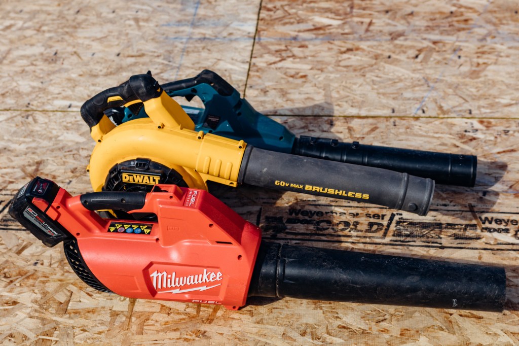

Comparing the Three
I had 3 other guys use the blowers and then I collected their opinions.The Makita hands down cleaned up fastest. What a couple of guys commented on, and I noticed as well, is that the Makita seemed to have more kick. It would actually move my arm back when I pull the trigger at full speed.
A caveat here though, is that all three of these units had different nozzle widths and even length. Milwaukee was the largest diameter and this is good for blowing out the van or shop because it moves a lot of dust without kicking it up. The DeWalt and Makita feel more powerful, but I think that is because the nozzle is smaller in diameter.
All three were reasonably quiet and won’t bother the neighbors but I’ll state it again, we are diligent about using hearing protection.
So I can’t say which really is the winner, but what I can say is that if you’ve invested into a cordless platform, buy a blower. We use them all the time, don’t have to deal with stocking fuel mix, and there are no fumes to deal with.
