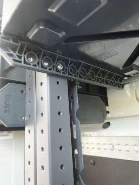

After many successful years in Europe, this German modular shelving system finally made its way to the U.S. It is designed to precisely fit the dimensions of your specific vehicle with zero drilling required and is configured when you order the system on the company’s website (systainersystems.com). All that is necessary to install the shelving are a few Allen keys and Torx bits, which are included in the welcome kit that comes with the shelving components. There’s no complex measuring and no wasted space; just affix the brackets to the frame and bolt them for a perfect fit.
Installation. Two weeks after I ordered my system, it arrived in two large Gaylord boxes on a wood pallet. The boxes contained a lot of parts, but once I read the illustrated instructions, things started to make sense. During installation, I was impressed by the accuracy of the brackets, which use preexisting holes in the van frame, so no drilling was involved.

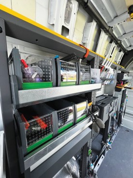

Galvanized steel shelving is available in several widths, heights, and depths depending on your needs, and each shelf comes with a rubberized material mat inside to stop cargo from sliding while also reducing noise. To get further organized, I added several different bottBox kits, which come in various sizes and fit neatly inside of the shelf. These work great for loose handheld items, such as tape measures and Allen keys.

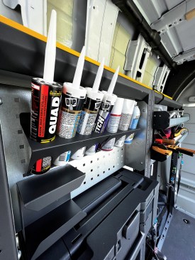

Among many other available options are slide drawers, perforated panels with the company’s configured accessories—such as spray-can and caulking-tube holders—and cable hooks for things like air hoses and saw blades. They make a huge difference in terms of cleanliness and organization.
The shelving and Systainer rails are installed with T25 Torx screws, which go into predrilled holes on the brackets, making alignment and installation easy, with zero drilling required.
In addition to the Systainer rails and shelving, the system can be configured with different-sized bottBox storage boxes.

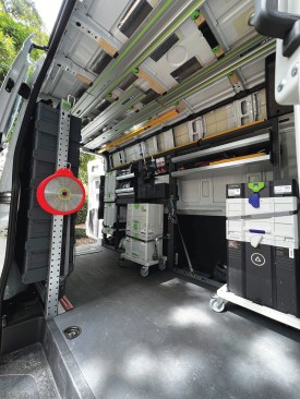

Ceiling-mounted guide rails. To mount my Festool guide rails to the van’s ceiling, I secured 1/2-inch-thick strips of plywood to the roof frame with threaded rivet nut inserts, a common fastening method used for camper vans. Then I fastened FastCap Track Racks ($25 a pair; fastcap.com) to the plywood with 1/2-inch-long wood screws. Metal rails tend to move and vibrate a lot during transport, and these guide-rail holders secure them nicely. They aren’t part of the bott Smartvan system but are a great addition to my work van.

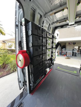

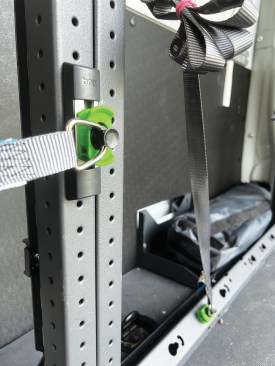

Security. bott Smartvan is one of only two companies worldwide to receive an ECE R17 crash test safety rating. This standard, which simulates a collision of an obstacle with a fully-loaded vehicle at 32 mph, focuses on fixing points, flooring, sidewalls, and overall construction of the shelving system. The bott Smartvan system is designed to keep tool cases and storage boxes firmly in place. The frames have integrated lashing rails that work specifically with optional bott Smartvan lashing straps and anti-slip mats to help prevent loads from sliding around. Lashing brackets that attach to the frame with T25 Torx bits are also available, allowing loads to be secured in any position.
Not only am I able to securely carry more tools and equipment, but I also have more space down the center aisle than I did with plywood shelving. This makes life much easier when I have to carry a big load of materials to a jobsite or (as I recently discovered) move my home. And once I had the new shelving and partition installed, I realized how unsafe I had been before with my plywood shelving. I’ve also noticed better gas mileage due to less weight, and the chassis of the Sprinter van feels more rigid, which has made driving on windy highways much easier.
Optional anti-slip mats and lashing points for cargo strapping can be added to the system.
The shelving can be configured for the way you work, with accessories such as spray-can and caulking-tube holders.
