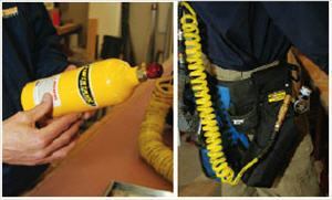

Sidearm Kit
This ultraportable tank is worn in a holster or carried in a shoulder-mounted sling. I tested kit version B, which contains two 1.25-pound bottles, a 0-to-160-psi regulator, a hose, a holster, a carry bag, and some other minor accessories. It costs $360. The next size up takes 2.5-pound bottles that fit in a sling.
The Sidearm works the same way as the larger tanks except that you carry it around with you. At first the bottle got in my way, so I took to putting it in the large back pouch of my toolbelt. It’s a good tool for someone who works at a variety of locations throughout the day. It’s also handy for doing punch-list items.
According to the manufacturer, a 1.25-pound bottle can drive 375 15-gauge finish nails or 190 8-penny commons. By my reckoning, that’s enough to install a few rooms’ worth of crown, hang and case half-a-dozen doors, or do a small amount of pickup framing. I found the tank’s small capacity a negative, because it constantly needs filling.
I would only buy a Sidearm as an accessory to a larger Power Tank — which, when connected to an $89 Power Filler attachment, can be used to fill the smaller tank on site. This would be a lot more convenient than going somewhere to get the bottles filled every time they were empty.
