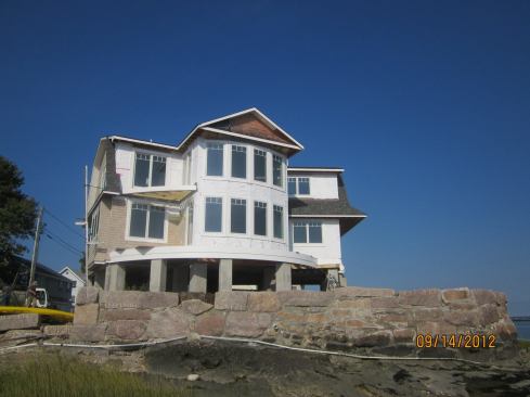

Campaigne has lots of experience with that type of job — because along the Connecticut shore, enforcement of FEMA’s “50%” rule has been rigorous. Under federal regulations, residents of any town are only eligible to get flood insurance from the FEMA-backed National Flood Insurance Program (NFIP) if the town participates in the program. That means the town has to have codes or zoning rules in place that require any building that is renovated or remodeled in a designated flood zone to come into compliance with FEMA standards for construction in the floodplain — that is, if the cost of the renovations exceeds 50% of the value of the building. At a minimum, compliance means that the first occupied floor of the residence has to be one foot above FEMA’s official Base Flood Elevation (BFE) as marked on flood maps of the area. Towns may or may not require an additional foot or two of “freeboard” above the BFE — but if a house does have two feet of freeboard, flood insurance premiums for the building drop drastically.

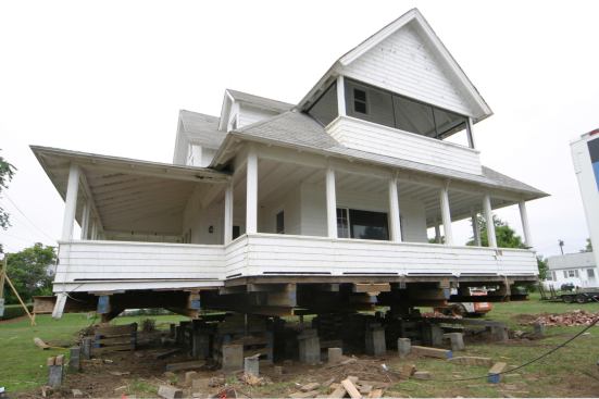

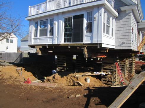

So what’s involved in bringing a house into FEMA compliance? For many houses he works on, the process is relatively straightforward, Campaigne explains: “It’s getting your first floor level up to base flood elevation. In the V Zone you’ll build a pier foundation, or in the A zone we’ll build a perimeter wall foundation with flood vents where needed, or a slab on grade. We’re mostly dealing with wood frame construction, and a lot of the cottages on the shore were originally built on granite piers set vertically. So they are already set up with an 8-foot grid pier foundation underneath them, and they actually lift pretty easily. It costs about $28,000 or $30,000 to lift a house, just for the lifting costs — you crib it up high enough to work underneath it, and then drop it back down onto a new foundation. The foundation costs are in addition to that. Bottom line, it costs about $100,000 to $125,000 to take a $3,000-sqft house up to compliance. And you have to bring all the utilities and everything up — your electrical meter has to be up above the BFE, and your gas fills and oil fills and all that. You have to ballast your propane tanks. There are a lot of little pieces that go into making it compliant.”
