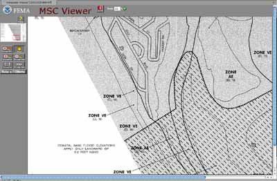

Currently, a scan of the most recent paper map is the likely result of an online search of FEMA’s Map Service Center. This example was the result of a search for the White Elephant Pub, on the water at 1855 Gulf Boulevard, Englewood, Fla. But online scans of old paper maps are a temporary mid-point in the transition to digital flood maps. Within a few years, FEMA’s servers will be displaying what some localities already provide: updated digitized topographic data stored in Geographic Information System (GIS) format, and displayed as an interactive map. Charlotte County, Florida, for example, has an interactive map server in place at www.ccgis.com. When we searched for the White Elephant Pub by the water on Gulf Boulevard in Englewood, Florida, Charlotte County served up this photo map, complete with a link to county property records.
