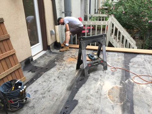

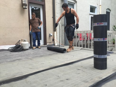

Prepping the Roof

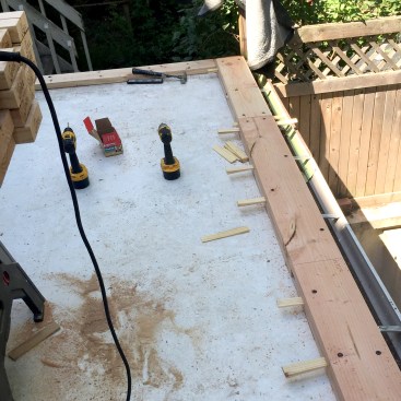

We began by installing a curb, made up of four layers of 2×10 SPF framing, around the perimeter of the deck. We fastened the first layer directly on top of the temporary roof membrane, bedding it in construction adhesive and screwing it to the roof framing with 4 1⁄2-inch HeadLok structural screws. To make sure the curb would be perfectly level when we installed the roof deck, we carefully shimmed the second 2×10 layer as we fastened it to the first, again with HeadLok screws. Adding two more 2×10 layers to the assembly brought it up to the proper elevation—determined by the threshold of the door leading out onto the deck—while providing solid support for the rail posts that would later be fastened to the curb.
Working on top of the temporary roofing membrane, project manager Danny DoCouto began by installing the first of four layers of 2x10 SPF around the perimeter of the roof, to create a curb.
Working on top of the temporary roofing membrane, project manager Danny DoCouto began by installing the first of four layers of 2×10 SPF around the perimeter of the roof, to create a curb.

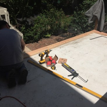

Because the curb establishes the final elevation for the rooftop deck, great care was taken to shim the second 2x10 layer so that it would be absolutely flat and level in every direction. 4 1/2-inch-long structural screws were used to fasten the 2x10 layers to the roof framing and to each other.
Because the curb establishes the final elevation for the rooftop deck, great care was taken to shim the second 2×10 layer so that it would be absolutely flat and level in every direction. 4 1/2-inch-long structural screws were used to fasten the 2×10 layers to the roof framing and to each other.
After building up the curb with two more 2x10 layers (creating a 6-inch-high curb), a roofing contractor installed tapered insulation panels to provide drainage, followed by a layer of 3/4-inch CDX plywood. Then he installed two layers of torch-down modified bitumen roofing membrane.
After building up the curb with two more 2×10 layers (creating a 6-inch-high curb), a roofing contractor installed tapered insulation panels to provide drainage, followed by a layer of 3/4-inch CDX plywood. Then he installed two layers of torch-down modified bitumen roofing membrane.
The curb is capped with 5/4 x 12 ipe, which was face-screwed to the curb with stainless steel countersunk fasteners. To help make the assembly watertight, the ipe was bedded in sealant.
To provide drainage, our roofing subcontractor installed tapered roof insulation panels, pitched toward a single opening that we left in the curb. Then he installed a layer of 3⁄4-inch plywood over the insulation panels, to provide a solid base for two layers of torch-down modified bitumen roofing membrane. The membrane laps up and over the curb, as well as a few inches up the two brownstone walls flanking the deck.
Finally, we installed a 5⁄4×12 ipe cap over the lapped membrane on top of the curb around the perimeter of the deck. We bedded the cap in plenty of roofing tar, then screwed the cap to the curb framing with 2 1⁄2-inch stainless steel screws driven through countersunk holes, which we later filled with plugs.

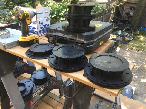

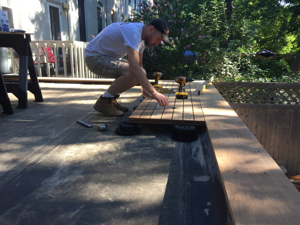

While we were unfamiliar with the Bison Versadjust pedestals that we used on this project, they proved to be pretty easy to install. These height-adjustable polypropylene pedestals come in different sizes and have an eccentric disk in the base that can be rotated to account for roof pitches of up to 5 degrees (about
1 in 12). Because of a 4 1⁄2-inch difference in roof height from the door threshold to the drain scupper, we ordered pedestals in four sizes: nine V1 pedestals, with a height range of 2 1⁄4 to 2 3⁄4 inches; 11 V2 pedestals (2 3⁄4 to 3 3⁄4 inches); five V3 pedestals (3 3⁄4 to 5 3⁄4 inches); and 10 LO low-height pedestals (1 1⁄4 to 2 inches). We also ordered various base levelers, shims, and accessories recommended by the supplier.

To account for the slope of the roof, Bison Versadjust pedestals are available in different sizes, each with a range of adjustment. They also have angled bases that can be rotated to provide a perfectly flat surface to support the deck panels.
The tops of the pedestals can be fitted with tabs to provide the proper spacing between panels.

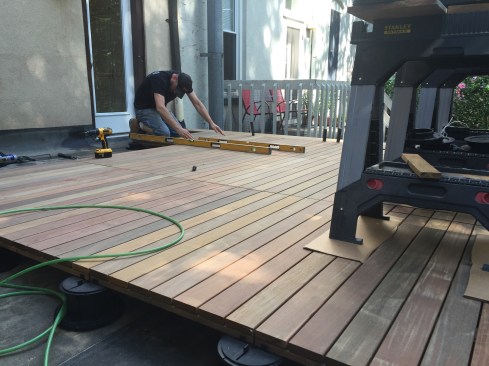

The height of each pedestal can be adjusted during installation, by turning its threaded shaft, to keep the ipe decking panels level with the curb cap and with each other. We used the curb cap to establish the overall level line for the deck, and occasionally used our laser to verify that we were maintaining that level as we installed the panels. Mostly, though, we simply placed a spirit level across the tops of the pedestals as we set them, fine-tuning their height as needed.
The pedestals can support different types of decking tiles, panels, and even stone pavers, but on this project they supported nominally-sized 2-foot-by-4-foot ipe deck panels (also sourced from Bison), at the center and four corners of each of the panels. The panels simply sit on the supports, which have upright tabs that maintain proper spacing between panels. Because the panels are heavy—about 50 pounds each—and because the deck location is not particularly windy, we opted not to use the optional plastic disks that can be screwed into the pedestal centers to lock the panels into place. We also wanted the homeowners to be able to easily lift the panels as needed for clearing out leaves and other debris.

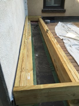

The PT base for the nearly full-width bench rests on sleepers, which are separated from the membrane roofing with strips of thick plastic.

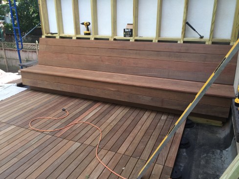

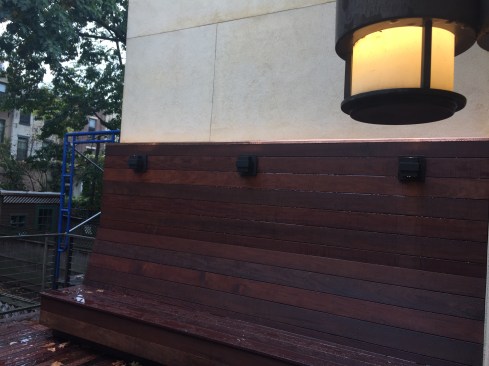

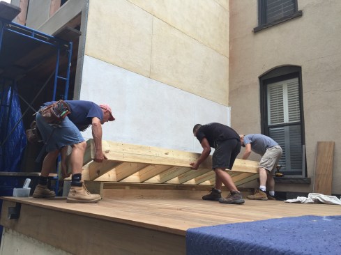

Ipe Bench
The plans included a generously sized ipe bench along one edge of the deck. We framed the bench with PT lumber, setting the frame on 2×6 sleepers, which rested on top of protective 10-mil plastic placed in turn over the roofing membrane. Because the wall it’s placed against belongs to the neighboring brownstone, we couldn’t anchor the bench to the wall, but it’s virtually tip-proof, thanks to its weight and low center of gravity. The bench is finished with 1×6 ipe and fitted with light fixtures controlled by a switch near the door and powered through conduit that runs underneath the deck panels for the electrical supply.
While we sized the perimeter curb cap to minimize cutting of the panels, we still had to do some trimming around the bench, as well as around a drain leader from the roof. But it’s pretty easy to resize the panels, since individual boards can be unscrewed from the cleats, resized as needed (we cut them with a jigsaw), and then reattached.
The bench frame was assembled from PT lumber. No fasteners were used to anchor the bench to wall behind it, which belonged to the neighboring brownstone residence.
The bench was finished with 1x6 ipe.
The bench was finished with 1×6 ipe.
The bench is fitted with lighting.

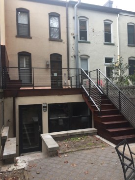

Stairs and Rail

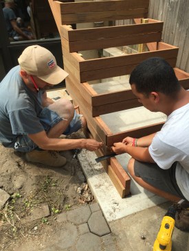

Because we had already contracted with a company called Custom Stair Builders (in Kenilworth, N.J.) to build stairs for a couple of other jobs, we hired it to cut the mahogany stringers for these stairs, as well. At $590 for materials and labor, the stringers weren’t cheap, but they were perfect.
The stair stringers were cut from 2x12 mahogany, while the risers, treads, and trim were crafted from 1x4 ipe.
The stair stringers were cut from 2×12 mahogany, while the risers, treads, and trim were crafted from 1×4 ipe.
Once the stringers were delivered, project manager Danny DoCouto anchored them to the deck frame and the new concrete landing pad that we had poured in the backyard. Following the architect’s plans, DoCouto then finished the stairs on site with ipe treads, risers, and trim.

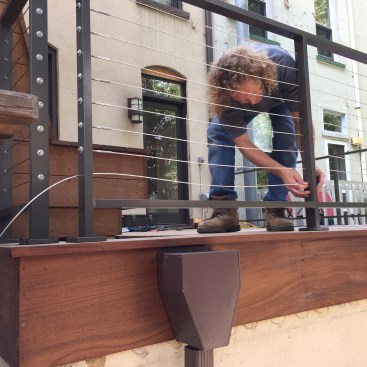

Meanwhile, a rail fabricator from Decorative Iron Works, of Patterson, N.J., carefully took measurements for the custom powder-coated aluminum deck and stair rails, which he fabricated in his shop and later installed. The rail system is finished with Feeney cable rail and fittings.
Water drains from the deck through a large scupper in the curb and runs through a custom-fabricated leader head. The powder-coated aluminum deck railing is also custom-fabricated.

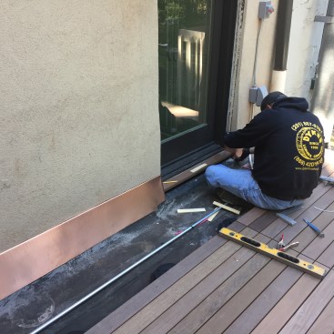

We also replaced the door leading to the deck. The original door had a rectangular transom window above, with a wide header separating the two units. We needed to raise the door slightly to accommodate the slightly higher deck (the result of improving the roof drainage with additional pitch). But by ordering a combination door–transom window unit (from Marvin) that eliminated the header, we were able to nudge the door up in the opening without extensive reframing. The door is set on a new concrete threshold that we cast in place, then carefully integrated with the roof membrane and copper wall counterflashing.
The project included a new door leading out onto the deck. Electrical wiring for bench lighting runs through conduit underneath the deck panels.

The new rooftop deck creates a comfortable backyard outdoor living space, a valuable commodity in urban New Jersey.
