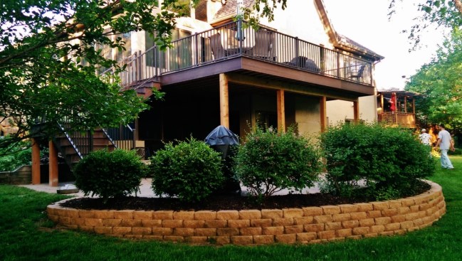

What should a contractor emphasize when evolving a deck-building practice into a full-service outdoor living company? According to Caleb Hunt of Creative Concepts & Design in Kansas City, Mo., design is the killer app. And that includes an effective design process. He credits his success, in part, to his collaborative approach.
When planning a complex project, Hunt gathers his concrete and landscape contractors together onsite with the homeowners. These are the big-picture subs who will configure the various outdoor spaces and make sure that each one complements the others. The team explores alternative layouts with the homeowners and hashes out details—a backyard charette, if you will.
Hunt approaches outdoor living spaces as a series of interconnected “rooms”—zones for cooking, dining, lounging, entertaining, or play—that need to flow together. “We approach this like an architect would,” he says. “[As a group], we ask the homeowners: How will you use each space? How many people will you entertain? Where will the main traffic paths be?” From there, the team works to optimize function and comfort.
The homeowners also get a better understanding of what’s possible at different dollar amounts, and why. All projects include budget tradeoffs, but Hunt finds that the in-person collaboration makes them happier with their decisions—and less likely to request change orders once work begins.

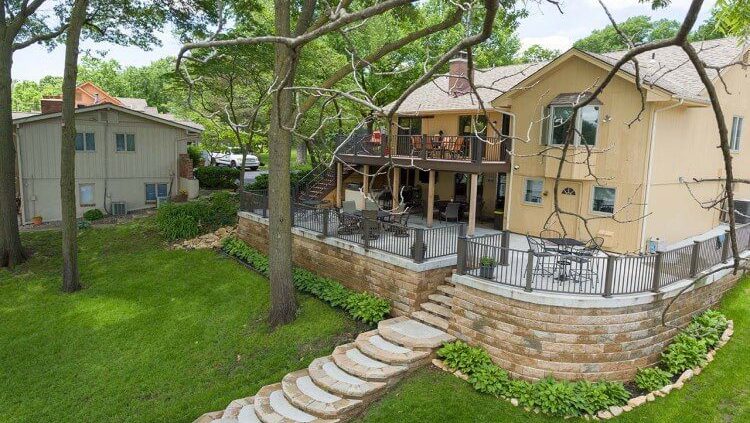

For instance, Urbaniak focuses on the shapes and elevations of concrete patios. “I also help them decide what finish they want—broom-finished, stamped, or stained—and give them ballpark pricing,” he says. “And I make sure the patio will work with Caleb’s deck as well as with Glenn’s landscaping and stonework.”
When it comes to stonework—whether it’s a wall defining a seating area, or a walkway connecting the project’s different zones—Rhees listens for stylistic preferences. “Do they want natural stone or stone veneer in certain areas? Or do they prefer something more contemporary like a stacked concrete product?” he says. Then he works with them to figure out how that lines up with their budget and their vision.
