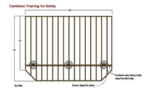

You can build a basic 8-foot-square dock, but it would be impractical for anything more than a place to put a couple of chairs. A fairly typical dock is a rectangle 16 feet wide by 12 feet deep (Figure 1). Generally, I crop the two outer corners of the rectangle at 45 degrees, back 2 feet to 3 feet depending on the dock’s width. This gets rid of the sharp 90-degree corners while leaving plenty of room to pull up a paddle boat, install a ladder, or go fishing.
Figure 1. Cantilevering the beam beyond the posts, and the joists beyond the beam, keeps the posts and footer forms under the dock. Otherwise, anyone jumping or falling from the dock could be injured by the edge of he footers.
The cropped shape works well with the cantilevered design I like to use. Cantilevering the cropped section allows me to install the outer support beam and outer posts closer to the shoreline — where the water is usually shallower and where digging the outer footers and setting the posts is much easier than it is even a couple of feet farther out.

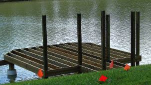

The next step is cutting the posts for the beam (Figure 7). I set my laser level on the shoreline reference mark that indicates the bottom of the joists and the top of the beam, then wade out to mark all the posts at this height. With a cordless saw, I cut the tops of the posts at my marks and notch them the full depth and width of a beam.
Figure 7. The outer posts are trimmed to the correct height after the concrete sets. White paint on the grass represents the maximum water level of the lake; the height of the framing should be several inches above that. The author uses a laser level to transfer this elevation from the shore to the posts.
