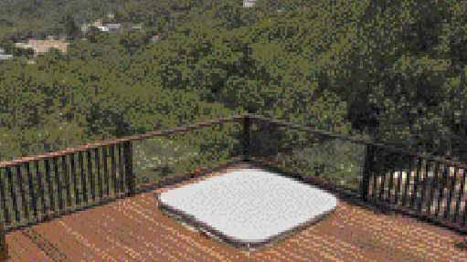

As a deck designer and builder on the West Coast, I occasionally build decks in what’s called the wildland-urban interface. The geography here is a little different from, say, the woodlands of New England. Winter rains on the California coast support plentiful vegetation, which then dries out in the summer to become a tinderbox (Figure 1). This large fuel source, coupled with high winds in the surrounding mountains and canyons, creates an environment ripe for the wildfires you see on the evening news.
Figure 1. Dried by the summer sun, wildland vegetation becomes the perfect fuel. Add a slope or canyon and its attendant winds, and you’ve got the makings of a devastating fire.

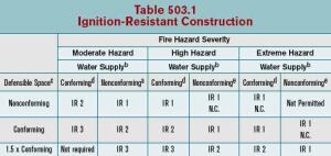

In any regulated area, building codes specify a particular class of construction depending on several conditions. In the 2006 IWUIC (Table 503.1, right), these include the fire classification of the area (moderate, high, or extreme), access to adequate water, and what’s called “defensible space” — an area cleared of excessive vegetation and other fuel for a specified distance from the house (see illustration, page 3).
a. Access shall be in accordance with Section 402 b. Subdivisions shall have a conforming water supply in accordance with Section 402.1. IR 1 = Ignition-resistant construction in accordance with Section 504. IR 2 = Ignition-resistant construction in accordance with Section 505. IR 3 = Ignition-resistant construction in accordance with Section 506. N.C. = Exterior walls shall have a fire-resistance rating of not less than 1-hour and the exterior surfaces of such walls shall be noncombustible. Usage of log wall construction is allowed. c. Conformance based on section 603. d. Conformance based on section 603. e. Conformance based on section 603.
Not much can be done to modify the first two conditions, but a property owner can control the defensible space. Wildland fires travel fast — in just five or six minutes, the majority of the flame front moves through — and minimizing the amount of nearby fuel reduces the chance that a fire will ignite a structure.
The distance the defensible space must extend from the house varies with the fire classification. Deadwood, dried leaves, and so forth should be removed from the defensible space, but fire-resistant vegetation is allowed, as are isolated islands of more flammable greenery and ornamental ground covers such as green grass and ivy — that is, assuming they don’t provide a means to transmit fire from the native vegetation to the structure.
Once the fire classification of the property is determined, Chapter 5 of the 2006 IWUIC defines Class 1, 2, and 3 Ignition Resistant Construction. For decks, the requirements for Class 1 and Class 2 construction are identical. The IWUIC has no prescriptive requirements for decks in Class 3 construction.

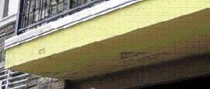

Even if that problem is surmounted, achieving a 1-hour fire rating is difficult. Neither the IWUIC nor the IRC provides much in the way of details for decks, so code in most jurisdictions reverts to the more commercial-construction-oriented International Building Code.
The IBC offers a plethora of ways to build a 1-hour fire-resistive structure. Most of these approaches, however, involve masonry, or they call for multiple layers of fire-rated gypsum board, which generally isn’t meant to be used outside and must be protected from the elements (Figure 3).
Figure 3. Building a deck that meets the IWUIC’s 1-hour fire-resistive construction requirement is a challenge. Wrapping the structure with a Type X gypsum sheathing is one approach; additional cladding will be needed to protect the gypsum board from the elements.
