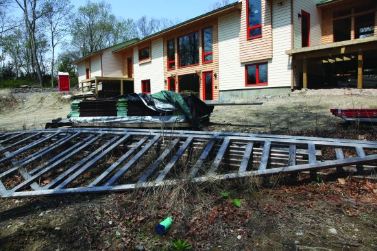

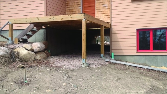

A recent project gave me the chance to employ a number of different water-management strategies. The first step in dealing with water around the house is proper siting. The builder, the owner, and I sited this house on high ground in a corner of the lot, so draining water away from the structure could be easily achieved. The soil on the site was a mix of sand and gravel that was good for drainage.
Pipes from the ground gutters, the downspouts, and the basement drain all join together and drain to daylight below the grade of the house, at a safe distance from it. The pipe is visible in the foreground.

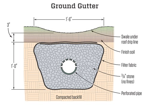

Part of my strategy for routing water away from the structure was installing what I call a “ground gutter” on the uphill side of the house (see Ground Gutter, below). The pipe in this assembly connected with a network of pipes from the downspouts and from the basement perimeter drain and eventually drained to daylight at a safe distance away from the house.
The garage sits on its own independent foundation, and the elevated mudroom entry between the garage and the house provides a clear path underneath for running piping from the back of the house to the front, where water can drain away safely.
I designed the house with four distinct parts: the garage, the mudroom and entry, the main house, and the screened porch and deck. Placement of the garage and the mudroom created an inside corner on the high side of the house with the potential for collecting groundwater against the foundation. To deal with that situation, I put the garage on a separate foundation and designed the mudroom as a bridge between the house and the garage. Elevating the mudroom gave the ground gutter a clear path from the rear of the house to the front, allowing groundwater to drain away from that inside corner. The bridge design also provided a convenient place to run downspout drains to the common pipe that connected to the daylight drain.
A ground gutter channels water from the perimeter of a house before it can collect and compromise the foundation. A depression or swale sits below the drip line of the roof. Water seeps through filter fabric and crushed stone before entering a pipe that carries it away safely.
Tim Healey
Along the rear of the house, the grade sloped away from the house, forcing groundwater to run parallel to the back wall. To manage the roof runoff, the ground gutter continued, situated directly below the roof drip line. This simple but effective strategy captures water where it hits the ground and uses gravity to move the water safely away from the house.

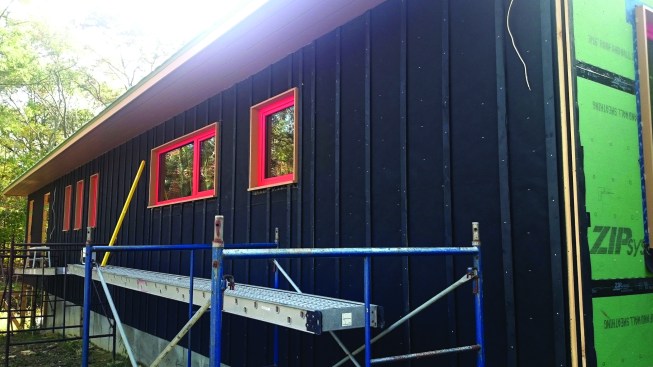

Black building paper, with 4-inch overlaps between courses, covers the side wall. To complete the drainage plane beneath the open plank siding, vertical strapping then attaches over the paper.
The horizontal siding nails to the strapping with gaps for ventilation between the boards. Note that the wide overhangs on the roof protect much of the siding and the windows from water.
The siding—1x6 boards painted on all four sides—is installed with a 3/16-inch gap between the boards and all adjacent material. The gaps provide ventilation for the back of the siding.
The siding—1×6 boards painted on all four sides—is installed with a 3/16-inch gap between the boards and all adjacent material. The gaps provide ventilation for the back of the siding.

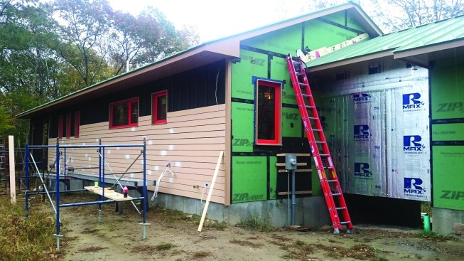

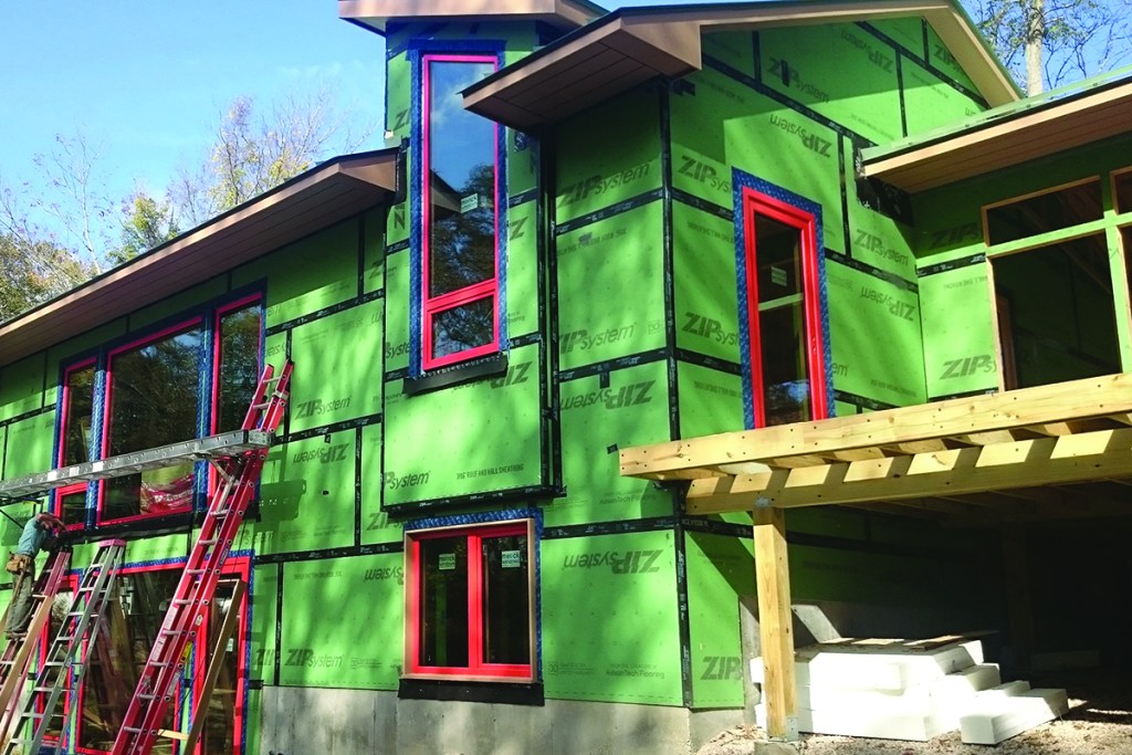

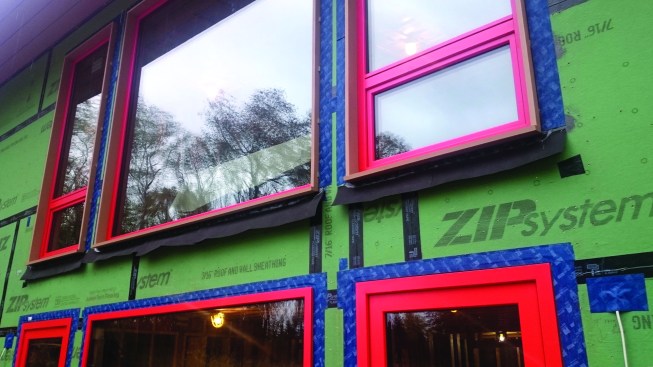

The primary weather barrier for all the exterior walls was 1/2-inch Zip System sheathing properly taped at all joints (see the photo at the beginning of this story). For the open-plank areas, the building crew applied black building paper—overlapped 4 inches on all the horizontal joints to shed water properly—over the sheathing. While the building paper does act as secondary weather barrier, its main purpose is to be the primary drainage plane behind the horizontal siding.
At each window sill, the crew installed additional 10-inch strips of building paper that we integrated into the sill pan. Those strips then lapped over the building paper on the wall to provide a proper weather lap at each window.
To mount the horizontal siding, the crew installed vertical 1×3 strapping, painted black, over the building paper. Aesthetically, the building paper and the black furring strips darkened the gaps between the planks that attached directly to the strapping. The siding was 1×6 quartersawn wood planks painted on all six sides and installed with a 3/16-inch gap between the boards on the sides as well as the ends.
Those boards provide the barrier for most of the water that hits the wall. The 3/4-inch air space created by the strapping allows the building paper to function as a drainage plane for any water that gets through the gaps between the boards. But more importantly, that space provides ventilation behind the siding, giving the siding a stable and near-uniform environment on all sides. That uniform environment minimizes the challenges to the paint and should extend the life of the finish and the siding significantly.

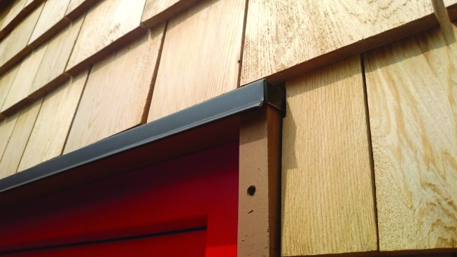

For the wall areas that were shingled, the crew installed the shingles over a vented rainscreen mesh. Here, too, they used strips of building paper at the window sills and integrated the strips with the building paper on the wall. Then they installed the rain-screen mesh on top of the black building paper.

Strips of building paper that will be integrated with the building-paper drainage plane provide additional protection for the window sills.
Certain wall areas are shingled in cedar for a visual accent. Rainscreen mesh applied over the building paper provides drainage space behind the shingles.

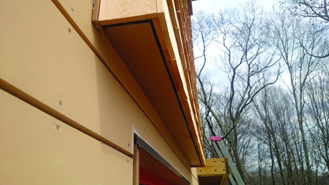

As an aesthetic treatment, a few of the shingled areas bumped out from the plane of the wall, creating shingled bays. These bump-­outs, much like the roof overhangs, also provide a measure of rain protection for the windows below. The bump-outs returned to the main plane of the wall and integrated with the horizontal siding via inside corner boards that were painted on all sides and attached to the wall over the layer of building paper.

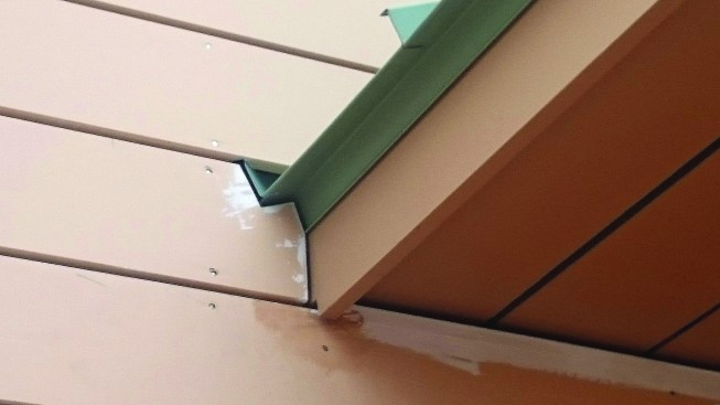

Where roof planes intersect with a side wall, the vertical part of the roof flashing integrates with the drainage plane of the wall. At the bottom of the flashing, a kickout flashing diverts water away from the siding.

Areas where roof planes intersect rainscreen walls are of particular concern in a water-management strategy. On this project, the mudroom roof and the porch roof, both standing-seam metal, intersected with the wood-plank walls. The crew installed proper flashing with a 2-inch vertical leg taped to the Zip System sheathing along the entire roof-to-wall intersection. The building-paper drainage plane then lapped over the flashing. Where the roof plane terminated at the eaves, a kickout flashing would channel away any water that might run down the flashing.

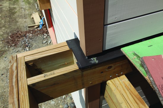

At the deck ledger at the bottom of the wall, flashing channels away any water from the drainage plane of the wall.
The other intersecting plane that had to be dealt with was at the base of the wall where the rainscreen met the deck frame. Here proper flashing on top of the deck ledger integrated with the drainage plane from the wall above to channel away any water that might drain down and accumulate.

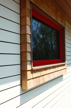

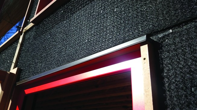

With the major wall-drainage issues addressed, the final challenge was integrating the parts and pieces that attached to the house into the water-management system. In addition to the building-paper strips mentioned earlier that provided protection for the window sills, proper head-cap flashing protected the tops of the windows and doors. The sides of the cap flashing were folded in so that the cap itself could properly channel water away from the window at the smallest level of detail. To match the aesthetics of the other windows, even the windows that enjoyed overhead protection received the same cap flashing.
Window cap flashing folds in to properly divert water on a micro scale.

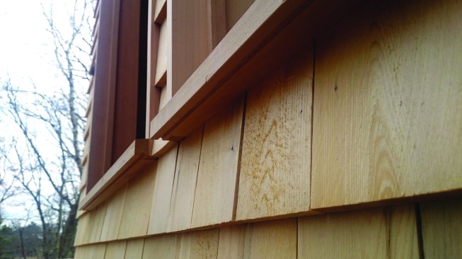

Grooves on the bottom edge of the window sill let water drip off instead of following the contour of the sill back to the siding.
The window sills themselves received a special treatment: A groove was cut along their bottom edges to act as a drip edge. Instead of the water following the contour of the sill and dripping down the wall, the water shed off the sill could drip away safely.

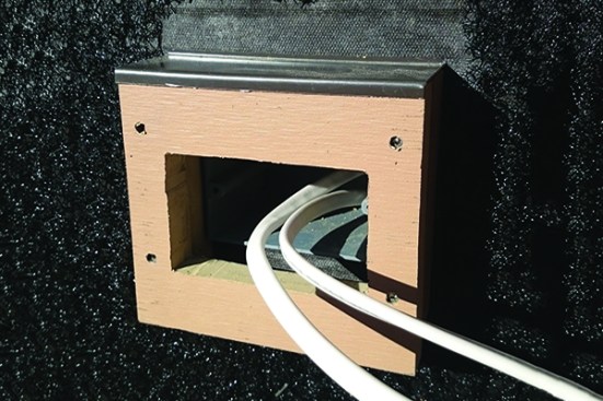

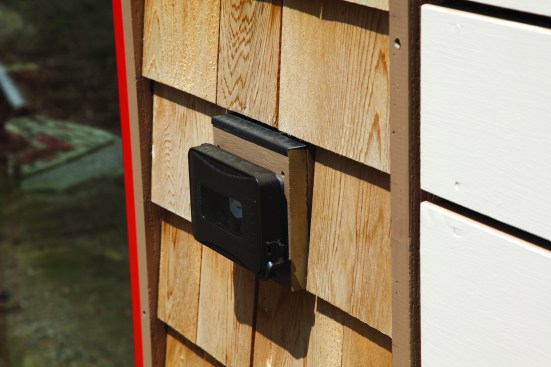

Exterior outlets mount into boxes that are flashed into the drainage plane and the rainscreen mesh.
Shingles then complete the outer weather barrier.
Electrical outlets and exterior light fixtures also received a cap-flashing treatment to integrate them into the drainage plane behind the shingled sections. Similarly, the building crew flashed in the backing boards installed for fall protection at the screen porch, and for the brackets that held the shade arbor over the basement walk-out doors.

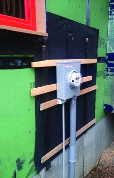

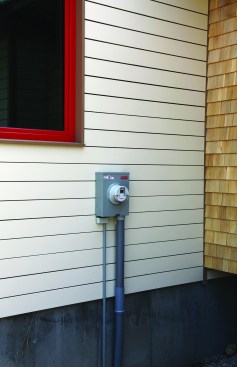

Temporary strapping the thickness of the siding holds the electric meter out from the strapping and the drainage plane until the siding can be installed.
The meter then attaches directly to the siding, keeping the drainage plane intact behind the meter.
Items such as the electric meter that mounted to the open plank siding received a little different treatment. The crew installed the meter temporarily on strapping that was the same depth as the siding. When the siding replaced the temporary straps and the meter was permanently installed, drainage and ventilation could take place behind it.
