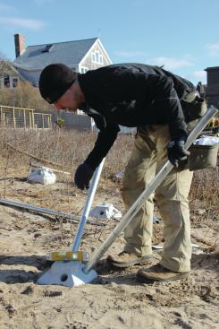

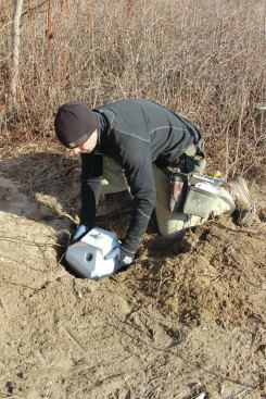

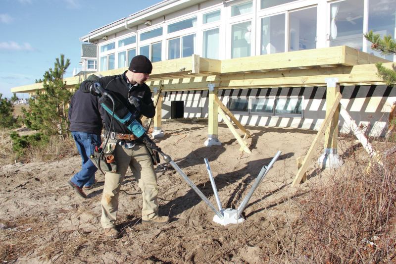

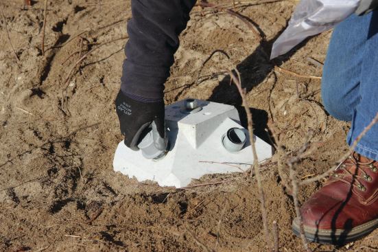

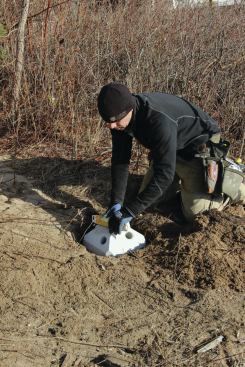

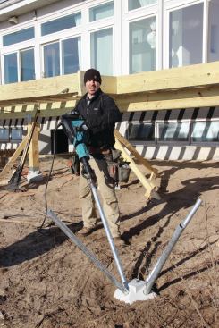

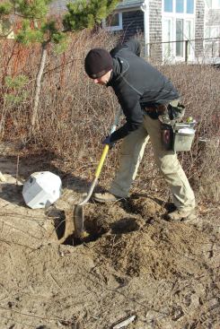

Installation starts with a shallow hole in the ground, just deep enough to cradle the bottom of the Diamond Pier head. One worker can carry the 75-pound pier head and set it in the hole by hand. Next, the installer uses a torpedo level to level the top of the head.

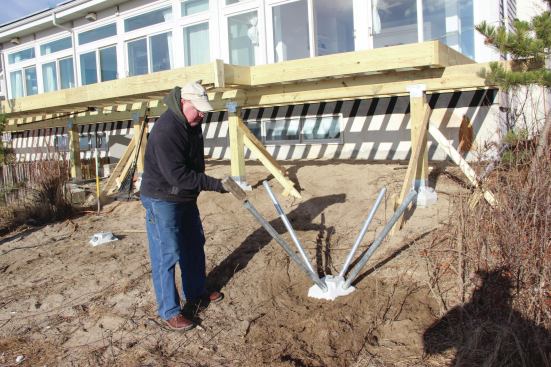

The concrete pier heads for Pin Foundations' DP50 and DP75 units weigh 50 and 75 pounds, respectively. The company also supplies a 100-pound pier head (the DP100) and a 200-pound pier head (the DP200), for heavier-load applications (where site-specific load engineering is typically required). The larger heads are too heavy for a single worker to manage, but in a pinch, workers can insert pin pipes into a head's guide holes and team up to carry and maneuver it by holding on to the pipes. The same method is also handy for aligning and leveling the smaller pier heads.

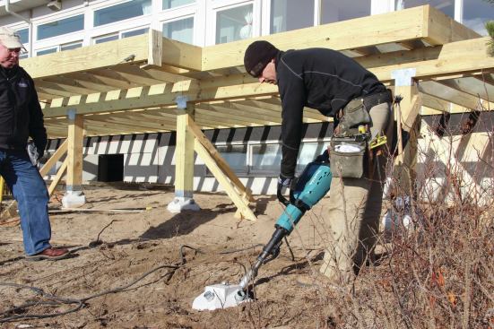

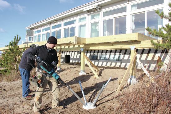

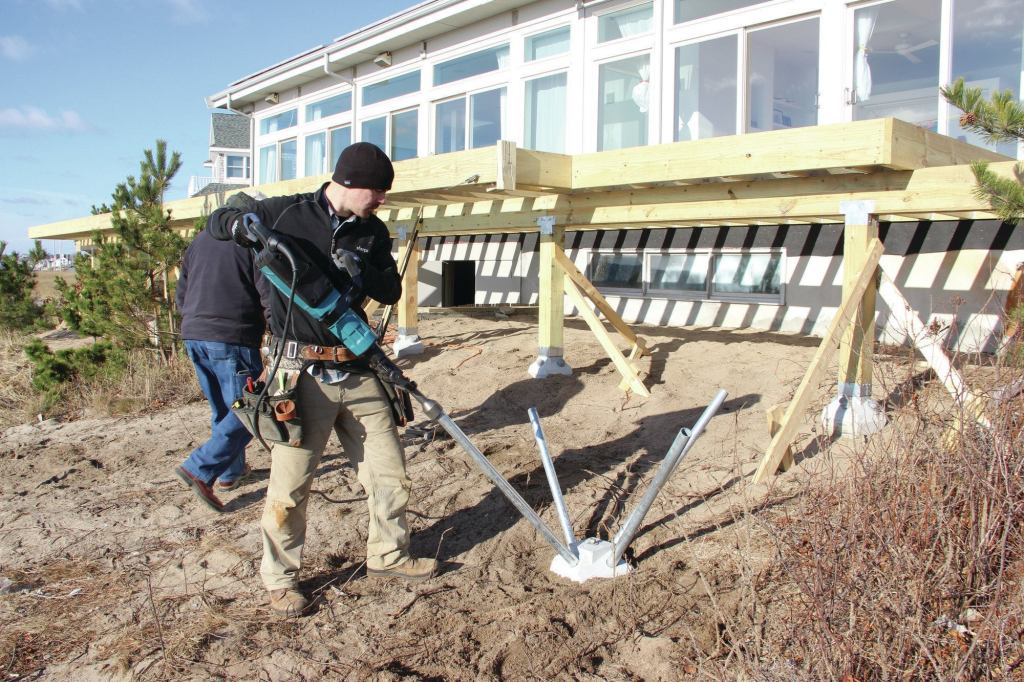

Once the pier head is suitably positioned, it's time to insert the pin piles, which are made of 2-inch Schedule 40 galvanized steel pipe. First, the worker inserts a pointed plastic plug into the end of the pipe to help the pipe penetrate the soil and to keep soil out of the pipe. The worker inserts the pipes into the guide holes in the pier head and starts the pins with a few blows from a sledgehammer. In average soil, you can drive pins all the way home with the sledgehammer—but it's much easier and a fair bit faster to use an electric demolition hammer and special driving bit.
Working around and around the pier head, the worker drives each pin a foot or so at a time before moving to the next pin. When a pin is fully set, the driver bit bottoms out on the pier head, leaving the pin protruding just enough to accept the sealing cap that serves as an inspection plug for the pin.

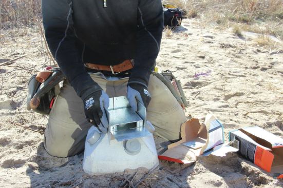

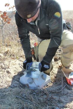

With the pier head set in place and pinned to the ground, all that remains is to set a galvanized post base: Place the base plate over the anchor bolt cast into the pier head, tighten down the nut, and position the standoff plate.

The minimal excavation required before setting the pier heads is a major advantage for the method. But how does the Diamond Pier support deck loads when the concrete element is resting on uncompacted topsoil? Simple, says Pin Foundations executive Mike Donoghue: The soil directly under the pier head doesn't carry any of the load. The concrete knuckle's function is just to lock the pins together and transfer loads between the pins and the deck post, Donoghue explains; it's the pins in the ground that transfer the load to the earth.
"When we do our capacity calculations," says Donoghue, "we neglect the first 10 or 12 inches of soil, because that's where you have tree roots and organic material, and that's unconsolidated—there's really not a lot of capacity up there. But as those pins are driven into the soil, they deflect just enough so that they lock into that head. And then when you load the structure on top, that further locks the pins into the head. So the head actually acts as a pin lock. And the pins transfer the load into the soil, but there's no bearing in the head itself."

In addition to labor savings, Horgan found that he saved time by not needing to wait for concrete curing and multiple inspections. "Even with a machine," he says, "to dig eight holes for 24-inch bases, pump those with concrete, then call for the inspector to come out and make sure the tubes are 4 feet down before we even fill them with concrete, and then come out again after they're filled with concrete ... you're looking at a two-week span from the time you dig the hole to the time you can actually stand a post on it and start your framing. I put six Diamond Piers in the ground in about 40 minutes—by myself. Just me and a jackhammer—and we were ready to start framing."
According to Horgan, the DP75 piers cost $175 each, which included all the necessary hardware, such as 4-foot-long pins (they also come in longer lengths for different situations); pre-installed anchor bolts; pointed end-caps for the entry end of the pins; and heavy plastic caps for covering the exposed end of the pins (which the inspector just pops off so he can check the depth at the same time he does the frame inspection). Hammer rental cost about $50 per day, though the pins can also be driven with a sledgehammer.
On this job, total installation time for 16 piers was less than two hours for one man, from pre-install stake-out to the start of framing.
