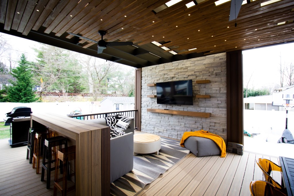

Bar seating takes up less space and will get more use. “It’s what I see people gravitate towards,” says Collingsgru. “With a bar top, you can fit five or six seats into 30 square feet, while a table and chairs night need 120.”
To maximize space further, integrate the bar top into what Collingsgru says is the most asked-for space: an outdoor living room. A 16-by-16-foot covered area is enough for a seven-person sectional couch, a standalone seat, and bar seating along the back of the couch. That’s 12 or 13 seats total. If budget and space permit, make it a little bigger and add a fireplace.
Whatever spaces the clients opt for, itis important design around the intended furnishings. Get the dimensions of each piece, then remember to include enough walking space around them.

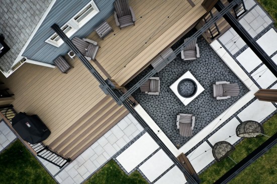

Hunt agrees. He says those “steps” can lead down to a patio, which will provide more space at an average square footage cost that’s 20% that of a deck. The clients could opt for formal dining on one level and casual entertaining on the other. If their yard space is big enough, suggest a pop-up tent for those big parties.
If clients are interested in a hot tub, the ground level won’t require beefed-up framing. And if it’s a second-story deck, the hot tub can be placed underneath it. “It becomes a value-engineered intimate space,” says Hunt.
Multiple levels can be a nice touch and have become popular on high-end decks. “On a second-story deck, we might do six stairs to a lower level, three stairs to a landing, and three steps to the ground,” says Collingsgru. These features can get pricey, but where the budget allows, they help define the spaces and introduce a cool visual element.
