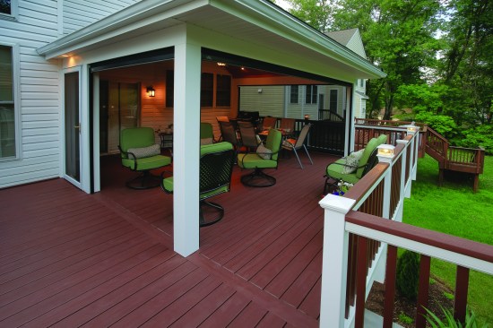

While fixed screen panels would create boundaries between the people using the porch and the adjacent deck, motorized retractable screens can quickly be used to remove those barriers when insects and weather conditions allow. A separate screen door is still required for regular access to the deck from the porch.

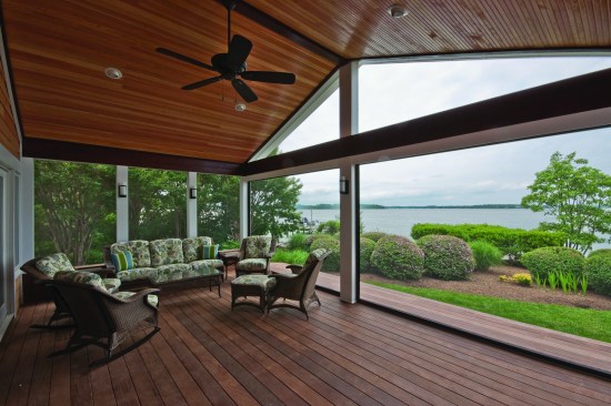

While the fixed screen panels we use are strong, we’re still limited to openings up to 8 feet wide (and closer to 6 feet in windy locations). In comparison, retractable screens can span clear openings that are as wide as 24 feet and up to 16 feet high, making them a good choice when there are beautiful lake or mountain views. Not only can the screens be completely retracted, but supporting posts every 4 feet to 6 feet on-center— that would otherwise obstruct the view—can also be eliminated. And even if a guardrail is required, the retractable screen in combination with a cable-rail system still does a great job of optimizing the view.
Retractable screens are also well-suited for situations where a porch and deck are connected to each other. If the porch wall facing the deck is equipped with a retractable screen, the screen can be opened up to make the porch more like a pavilion, creating a single spacious area.

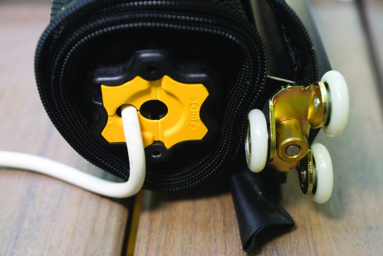

A Somfy tubular motor that can be inserted into either end of the rolled-up assembly powers the screen.

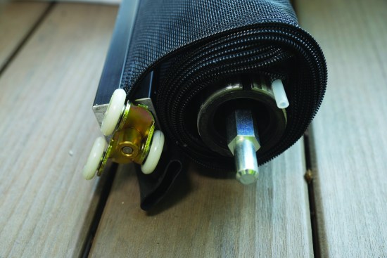

A pin at the other end of the rolled-up assembly fits into the mounting bracket, while the bottom of the screen terminates with a heavy aluminum bar with rollers mounted to the ends.

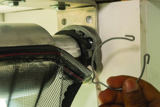

A clip locks the assembly to the mounting bracket.

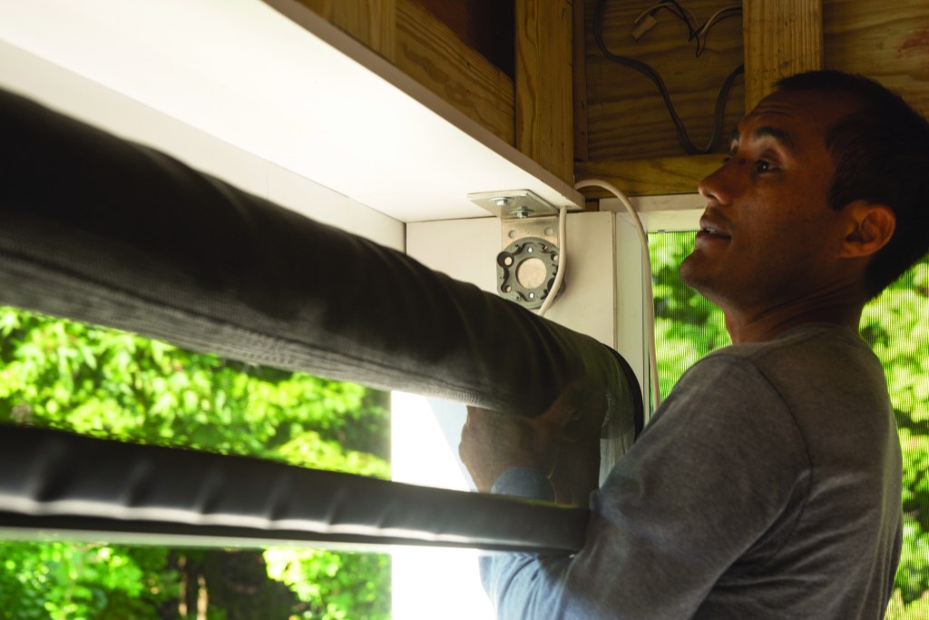

The screen assembly is supported by a pair of mounting brackets that are lag-screwed either to the header trim or to the inside face of the exterior head casing. Before installing the brackets, I drill a hole for the electrical cable and feed the wiring through the hole. The brackets are then secured with a pair of lag screws, which are supplied with each unit.
After inserting the cylindrical motor into the rolled-up screen assembly, I mount the assembly into the brackets and lock it into place on the motor side with a lock pin. On the project shown here, the screen unrolls toward the inside of the porch because of the railing location, but the screen can also unroll toward the exterior.

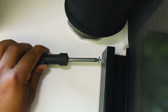

Once the screen is in place, I unroll it about half-way, then carefully measure and cut to length the aluminum tracks that guide the screen up and down. I’ve found that cutting them a little short provides clearance for the rolled up screen and allows for a better fit. After the rollers have been inserted into the tracks, the tracks are then screwed to the jambs, with a set screw at the top to prevent the rollers from jumping out of the track.
Set screws at the top of the aluminum tracks prevent the roller assemblies from jumping the rails as the screens retract.
