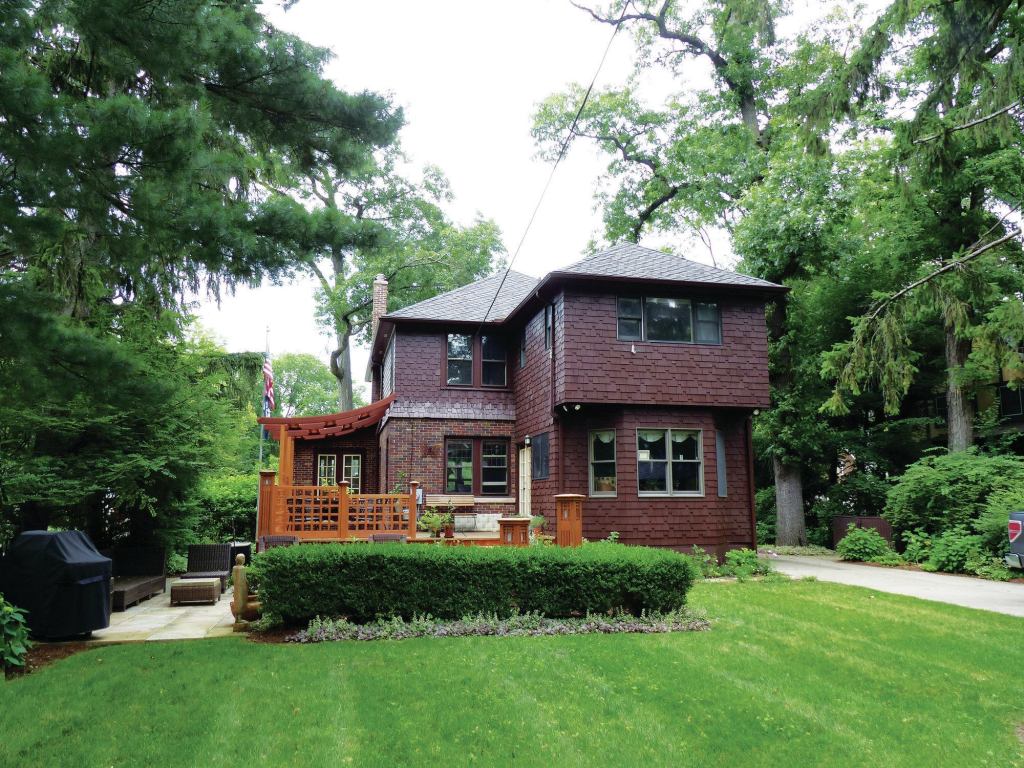

Now a designated National Historic District located just nine miles north of Detroit, Pleasant Ridge was originally developed as a summertime retreat for Detroit businessmen and their families. Here, titans of the Gilded Age built a small community of sumptuous weekend “cabins” representing an eclectic range of architectural styles including Tudor, French Colonial, and Georgian Revival. Our client owned one of these homes—a sprawling Arts and Crafts bungalow—and had contacted us after visiting our website looking for ideas for her aging deck.
Design
Because the neighborhood’s designated registry is more forgiving than a Heritage status, we were able to move forward on the project without triggering a design review. Without stretching the home’s existing aesthetics too much, we drew from the precedent of the curved roofline of the existing sunroom in our design of the four bent laminated trusses. The curved trusses are joined together by a series of small staggered panels that stabilize the assembly while offering the illusion of a roof overhead.
Offsetting the muscle and length of the trusses and linked visually with the connecting overhead panels is the more subtle intimacy of a series of open, flush-joined grid panels that span the perimeter of the deck. Three of our #8 lighted Garden Columns—one of them integrated into the deck railing, and two others in the nearby landscape—complete the design.

The first two 66-inch-high panels were designed with window-like portals to accommodate the homeowner’s morning coffee routine on the lower deck. The design creates a sense of privacy, but avoids the fortress effect of an opaque separation. The grid sizes remain consistent around the perimeter of the deck, with the horizontal grid dividers in alignment regardless of the varying panel heights.
The curved trusses suggest a ceiling without closing in the space.
