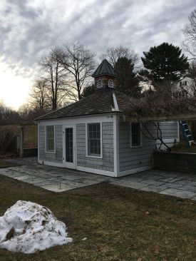

The original pool house. Piers have been poured for the new deck, and new bluestone pavers have been installed. The next step is to remove the cupola, which will be reinstalled later.

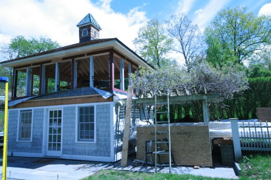

After I finalized the plans with my client, the first step was to remove the existing cupola, which would be saved and reinstalled later. We set up a pair of 24-foot aluminum scaffolding planks covered with plywood and used a combination of ropes and muscle power to slide the cupola safely off the roof and down to the ground. Then we stripped off the old shingles and disassembled the roof framing down to the top plates.

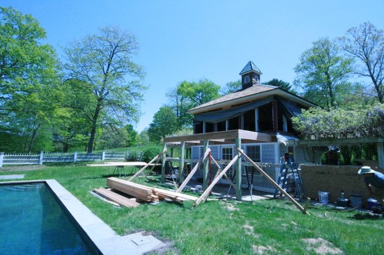

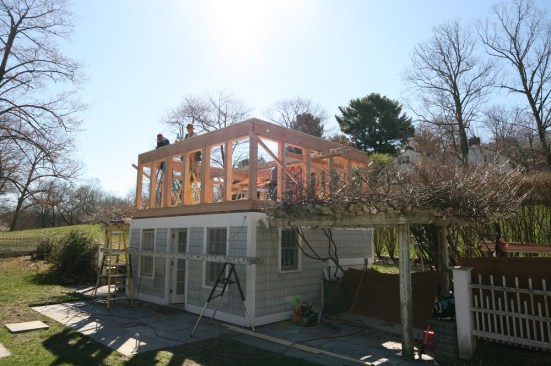

Next, we installed a new floor system and framed up the second-story walls. Because of the many window and door openings, the wall framing consists primarily of a continuous header around all four sides of the structure, supported by trimmers for the 22 rough openings.
Since there’s no plywood sheathing to brace the walls, we custom-fabricated steel brackets out of 1/4-inch steel plate for the corners and trimmers to prevent racking. We coated the brackets with a primer and fastened them to the wall framing with 3-inch by 5/16-inch-diameter lag bolts after the roof was framed and sheathed.
Kyle Diamond
The new second-floor wall framing consists primarily of window and door openings.

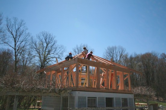

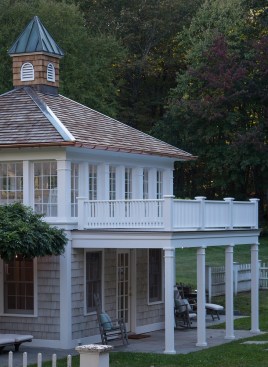

The new hip roof has the same 6/12 pitch as the original roof.
Our client wanted the new roof to match the look and pitch of the roof that we had removed. So we framed the new, regular hip roof with a 6:12 slope, starting with the short ridge and common rafters (see “Laying Out a Hip Rafter,” JLC, Dec/17). After sheathing the roof, trimming the fascia with Boral TruExterior poly-ash trim, and installing copper drip edge and cedar shakes, we re-installed the cupola, sliding it back up into place using a rope come-along and the same scaffolding setup that we had used to remove it. Then we started on the new deck.

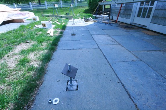

The deck framing rests on 6×6 PT posts supported by 4-foot-deep-by-12-inch-diameter poured concrete piers, but we didn’t want the tops of the piers to be visible around the post bases. So we came up with a post-base connection detail that would allow us to make the cutouts in the bluestone pavers around the piers smaller than the posts. This meant that the post bases had to be elevated slightly above the surface of the pavers.
When we poured the piers, we embedded long 1/2-inch-diameter galvanized anchor bolts in the concrete and bored matching holes in the centers of the post bottoms. Before sliding a post down over the bolt, we threaded a nut onto the anchor bolt followed by a 1/2-inch-thick galvanized steel plate, which supports the post base and holds it up off the ground.

Holes were bored in the base of each post to allow it to slide down over the 1/2-inch-diameter anchor bolts embedded in the piers. Threaded nuts and steel plates hold the post bases up off the piers and the bluestone pavers that are cut closely around them.

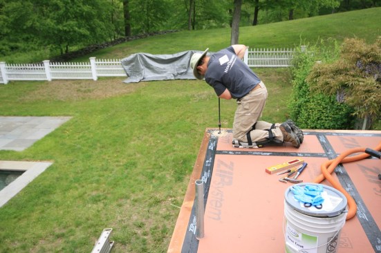

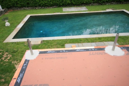

Before installing the Acrylabs coating, we located our rail-post centers around the perimeter of the deck and bored holes for 1 1/2-inch-diameter galvanized steel pipe. The holes penetrate solid blocking installed between the rafters in each of the post locations. Before inserting the pipe, we squirted a generous helping of polyurethane construction adhesive into the holes to lock the pipes in place.
Isaias Santos
Holes bored down through the sheathing and into solid blocking installed between the floor joists provide solid support for the 1 1/2-inch-diameter galvanized steel pipe the author used to build the rail post assemblies.
Isaias Santos
The post pipes were sealed to the deck sheathing with the Acrylabs roof coating. Later, 2×4 PT blocking will be installed around the pipes to form a base for the post wraps.
After sealing the pipe openings and applying the deck coating, we wrapped the galvanized pipe posts with 2×4 PT blocking to provide a solid base for our column wraps. To lock the PT to the posts, we cut V-shaped notches on the faces of the 2x4s that lie against the pipe. Once the assembly was screwed together, the posts were rock solid and ready to be wrapped with Boral trim.

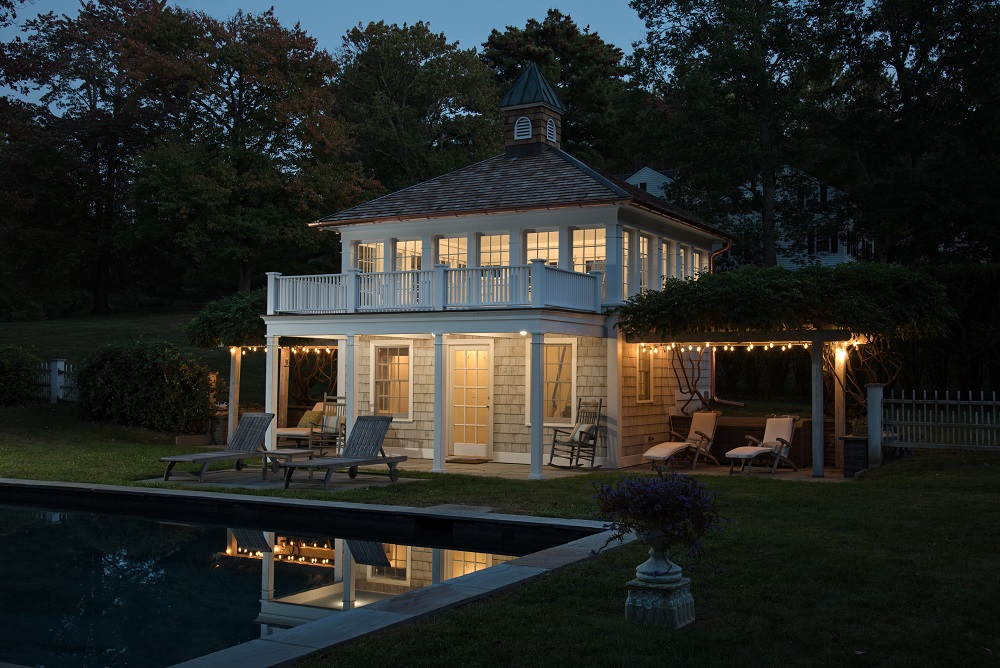

The railings and balusters were built out of clear red cedar. Note the deck's slight pitch, to allow the waterproof walking surface to drain properly.
Ion Zupco
Following the architect’s design, we milled the railing parts out of clear cedar, which we cut, primed, and painted on site. To shed water, we beveled the top of the 2×4 hand and bottom rails slightly, and we used square 1 1/2-inch-by-1 1/2-inch balusters to create the look of a southern porch railing. We used Festool dominoes to assemble the railing.

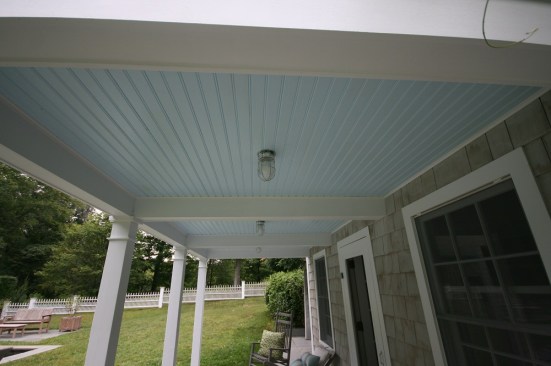

The beadboard porch ceiling was painted robin's egg blue, completing the traditional look.

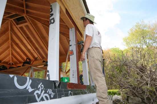

To finish up, we wrapped the support columns and fascia with Boral trim and installed a traditional beadboard ceiling.
