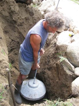

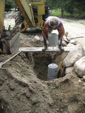

Once the hole is prepped, it takes only about a half-hour to assemble the pier. You start by inserting the galvanized rod through the base section—which weighs a manageable 80 pounds or so—and lowering the base into the hole (see photos).

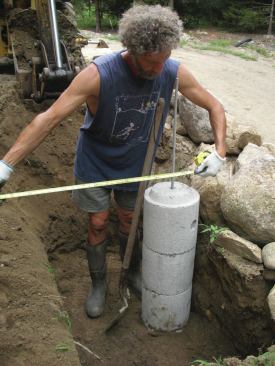

Once the base is set and level, the remaining sections slide into place over the rod. Each section has a 1 1/2-inch crown on top that mates with a recess in the bottom of the next section so they are aligned when stacked. The manufacturer recommends applying a sealant or mortar between the section joints during assembly. While there’s no structural benefit to the sealant, it does help to keep damp soil—which can freeze and expand in cold temperatures—from collecting in the joints. This shouldn’t be an issue in well-drained soils.

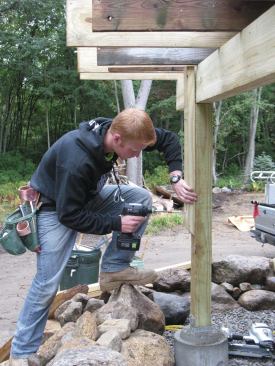

With the pier assembled, the post base can then be bolted to the end of the connecting rod, which must be cut to length. Before snugging up the nut and backfilling, though, make any final adjustments to the stack so that the post base will be in the proper position relative to the framing. I found that I could shift the stack an inch or two in any direction to dial it in.

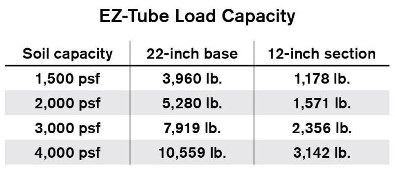

EZ-Tube piers can be installed with or without the base section. Once installed, the pier can handle virtually any deck load that you throw at it, with the limiting factor being the bearing capacity of the soil beneath (see chart, below).
