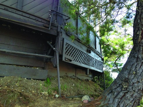

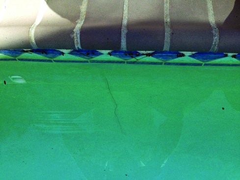

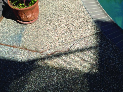

Though still beautiful, my clients’ backyard was clearly in trouble. Part of a home that was built atop a knoll in Belmont, Calif., in the 1960s, the backyard contained a gunite pool that had developed a noticeable crack and was regularly losing water. Along with it, the surrounding concrete and wood decks were also failing. In fact, the backyard was in motion, largely the result of rotted wood laggings in the retaining wall that flanked one side of the pool and was supporting everything.

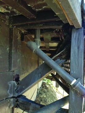

The 4- to 8-foot-tall retaining wall consisted of a series of vertical steel I-beams encapsulated in concrete. Perched atop the retaining wall around the outside perimeter of the pool was a cantilevered 4-foot-wide concrete-slab walking surface, which was supported by a framework of wood and aluminum. While the I-beams seemed sound, there was no way of knowing for sure without stripping away the existing structures.

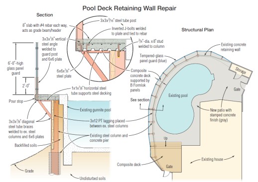

We thought that we could solve the problem by replacing the existing pool deck with an engineered system of square tubular steel framework supporting a steel-reinforced concrete slab. But the condition of the I-beams was one of the keys to the project: If they could be re-used, it would result in a $70,000 to $100,000 savings in the overall budget, because to bring in an excavator to drill new holes and set new steel I-beams in concrete on a 40% sloped hill would be no small or inexpensive task.

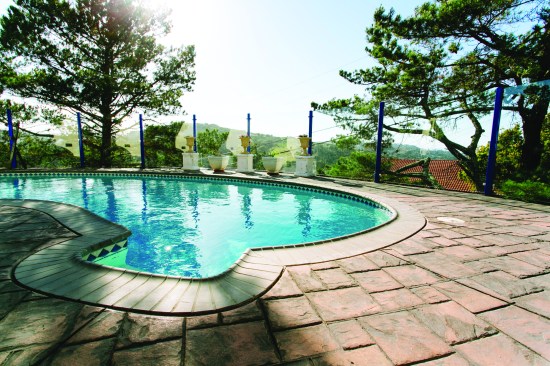

To solve these problems, engineer Javier Chavarria designed an 8-inch-thick, steel-reinforced, horizontal concrete slab that would lie on top of B Formlok galvanized-steel pan decking. It would serve as both a header and a grade beam wrapping around one side of the pool and connecting to the thinner, main slab surrounding the entire pool. This would create a diaphragm effect, so that the main header/grade-beam slab would derive some of its strength from pulling on or tensioning the main slab. This element of the construction would run parallel to and over the retaining wall, and it would carry all of the loads and stresses of the I-beam wall, the pan deck with concrete, and the wind loads on a 6-foot-tall tempered-glass enclosure, which would act as the required guardrail and as a wind block.

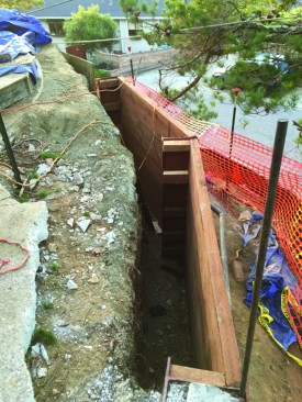

Retaining-Wall Repair
Since the construction began during the winter, there was some concern about the possibility of the pool becoming a concrete boat and floating right out of its anchorage in the soil. If it rained, and the area surrounding and under the pool filled with water and became a buoyant force, it could overcome the weight of the pool itself. We were also concerned that as the timber laggings between the existing I-beams were removed, the pool might crack more and want to move down the hill and toward the existing failing retaining wall. In consultation with the soils and structural engineers, we drained only as much water as was necessary to adequately reduce the stress exerted by the water in the pool on the pool wall and the existing crack, but still prevent the pool from floating.
The existing concrete slab flanking the edge of the pool was demolished to expose the steel columns supporting the retaining wall. Blocks held the new 3x12 PT timber laggings in place until the excavation could be backfilled.
The existing concrete slab flanking the edge of the pool was demolished to expose the steel columns supporting the retaining wall. Blocks held the new 3×12 PT timber laggings in place until the excavation could be backfilled.
After we completed demolition and exposed and inspected the I-beams, it turned out that only one (out of 17) had damage that required repair. That consisted of a 2-inch hole that we repaired—to stronger than new—by welding two 8-by-12-by-1⁄4-inch patches of steel plate onto the I-beam. Then we cleaned and wire-brushed the I-beams, primed them with two coats of metal primer, and installed stout, 3×12 pressure-treated number one or better Douglas-fir timber laggings.

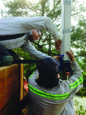

The prefabricated guard-post assemblies were temporarily clamped in place, then welded to the columns.

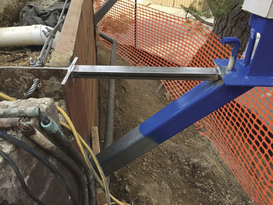

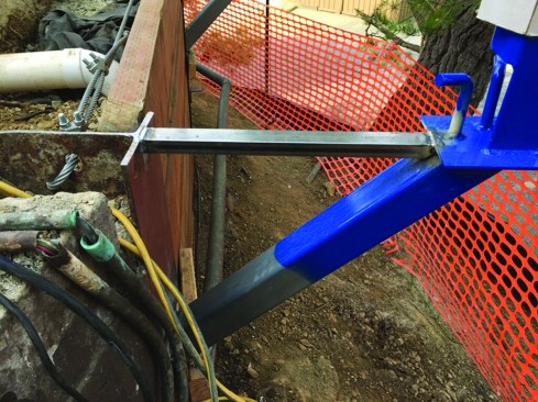

To save a great deal of cost, we fabricated and powder-coated off-site the many tubular-steel knee braces that were needed to support the pan deck (all welding for the entire project—except for the pan deck itself—had to be performed by a certified welder, with special inspections). Then the knee braces had to be welded into place onto each I-beam to form the tremendously strong support system engineered to handle the load of the wet concrete that would lie on top of the pan decking.
Horizontal steel tubes welded to both the columns and the guard posts stabilized the posts and helped support the Formlok panels when the concrete was poured.

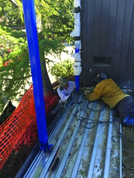

Pan Decking
Pan decking comes in various sizes and shapes and is usually made of galvanized plated steel. Ordinarily, it is specified in the design drawings, as was the case in this project, but it does not always have to be engineered. While we often work with steel, we weren’t familiar with installing pan decking, but it turned out not to be that difficult.

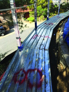

After the guard posts were welded to the columns, workers cut and fit the B Formlok galvanized steel panels that would support the cantilevered portion of the new concrete slab.
The material, which looks very similar to the corrugated plastic material some patio roofs are made of, can be cut using a standard wormdrive saw with a metal-cutting blade. We mitered the ends, just as you would miter a piece of decking, and used self-tapping screws and performed some MIG welding (non-certified) to install the pieces of the pan decking. As long as the pan decking stays in place and can support the weight of the wet concrete, it is merely a form until the concrete hardens. The fastening can be “just-enough” in a situation like this. We protected the areas of welding by cold-galvanizing them. At any of the joints in the pan decking—where concrete might leak through—we used duct tape as a sealer.
A pour stop of 1/4-inch-by-6-inch steel welded to the posts forms the edge of the slab.
The pan decking was needed and installed only in the areas that cantilevered out over the retaining wall. Next, we tied up the matrix of steel rebar that would reinforce the slab, as specified in the drawings. When Bob Peek and the crew from Burch Brothers Concrete poured the monolithic slab that tied the whole assembly together, they colored the concrete and stamped it with its finish surface. All of this was done without attaching to the pool at any point, just as the engineer had promised (see illustration, above).

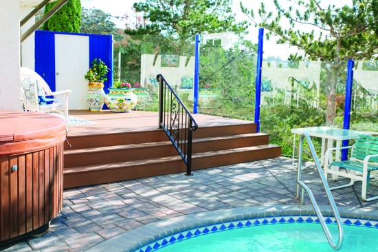

Meanwhile, we framed a new deck at the end of the pool, which we later finished with Azek composite decking, again taking advantage of a cantilever design concept. Using the I-beam retaining wall and various tubular steel arms, knee braces, and additional pressure-treated supports, we cantilevered the deck out over space. Much of the steel work was non-welded and consisted of drilling holes through the steel and then mechanically fastening the components together with bolts, a technique that we’ve often used on other hillside projects in the San Francisco Bay area.
Glass Guardrail

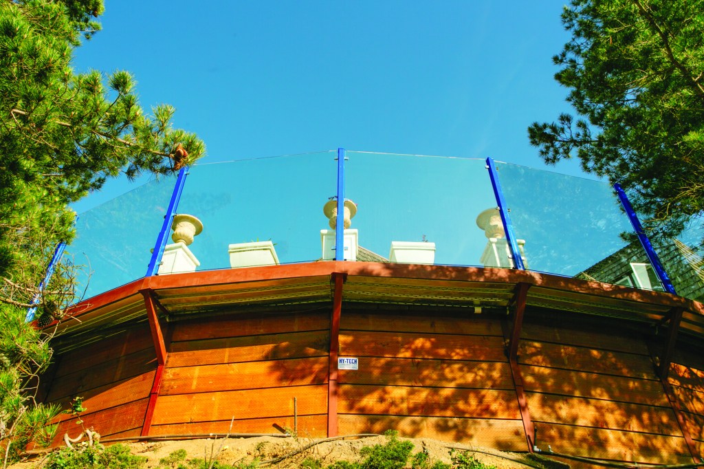

The crowning jewel of the entire project is the 6-foot-tall tempered-glass panel guard that surrounds one entire side of the pool. That barrier—which serves as both a 6-foot-high pool fence and a 42-inch-high guardrail—was required by the Belmont Building Department, because the drop-off at the edge of the concrete slab to the street below is as much as 20 feet. There was a $26,000 upcharge for the tempered-glass fence over a typical wooden fence, but our clients felt much more comfortable paying it after learning that the total cost to repair the I-beams was only $700 as opposed to the estimated $70,000 to $100,000 it would have cost to replace them.
Although the new concrete slab is important structurally, it has a decorative colored and stamped finish, flush with the original coping around the gunite pool.
The final design of the glass and posts—a collaboration of the owners, our structural engineer, Dave Capps of D.J. Capps Glass Company, and me—consists of blue powder-coated engineered 3-inch-by-3-inch steel posts and chrome-plated shower panel brackets, with the backs machined on the various angles required to compensate for the radius of the pool. The 6-foot-by-6-foot by 3⁄8-inch-thick tempered-glass panels rest on rubber support pads on metal brackets welded to the posts.
Partially cantilevered steel framing supports the new composite deck at one end of the pool.
The glass supplier needed to deliver the glass in several truck loads because of its tremendous weight. This glass—along with the steel posts, brackets, and anchorages into the concrete header-and-beam assembly—can handle the potential 100-mph wind loads that may act on it over the years.
