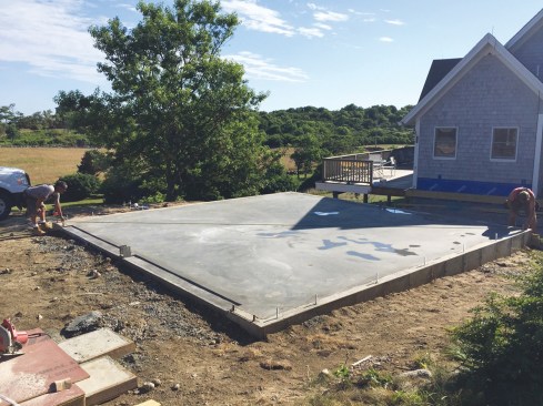

Level starts with the foundation or base. If the concrete crew does a good job, you can bolt the sill plates down, and everything you do from there up will be level. If the concrete crew doesn’t do a good job, however, you need to start by shimming, planing, wet-setting, or otherwise leveling the plates.
Start with a level foundation—no more than 1/8 inch out of level throughout the building. After confirming that the foundation walls are parallel, lay out and snap chalk lines for the mudsills

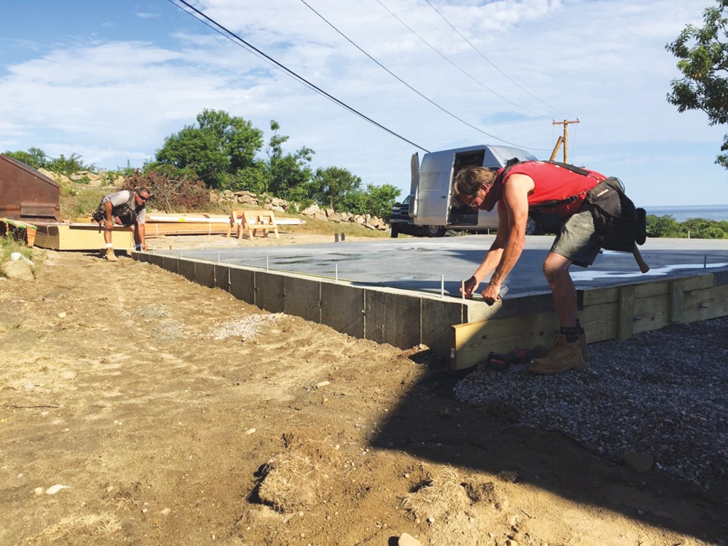

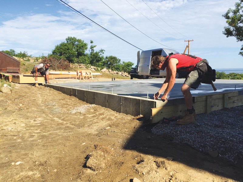

Don’t try to measure diagonals on a long, narrow rectangle, such as a wall 32 feet long and 8 feet high, because it will be difficult to adjust the diagonals so that they are equal. It’s better to break a long wall section into two shorter rectangles, which will result in diagonals with less acute angles that are easier to accurately measure and adjust. You can also start by trusting the foundation, snapping two sets of parallel sides, checking the diagonals, and adjusting to fit. I sometimes use blue chalk until I’m satisfied, and then permanent red chalk for my final layout.
I almost always snap the inside walls for the sill plates, because the outside lines are too close to the edge, and because I won’t be able to see them when the walls are sheathed and stood. Remember that almost all pressure treated lumber is 1/8 to 1/4 inch wider than regular lumber. You can keep the extra inside or out, but be consistent and allow for it.

When the foundation is less than perfect, you will have to shift, twist, or adjust the size of the entire layout to fit. It’s almost always easiest to expand a building slightly if the foundation is a little bit out of square—that way, you don’t need to fight with getting water table trim, siding, door thresholds, and other elements to fit. If it’s way out of square, you need to figure out where to hide it, or where it’ll be easiest to fix. Often, additions, bump-outs, and wings are not square to the main part of the foundation; you can shift the main rectangle to make these parts fit better.

Before starting to assemble the wall, pin or tack the bottom plate along a straight line. Square up the wall by measuring the diagonals from the corners of the plates.

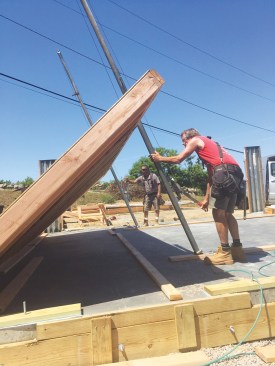

After the wall sheathing is nailed off, the wall can be lifted into place on top of the sill plate (here, the author is using wall jacks).
Leaving the anchor bolts loose allows for adjustment as the remaining walls are raised. Use diagonal bracing to hold the walls plumb and in position.

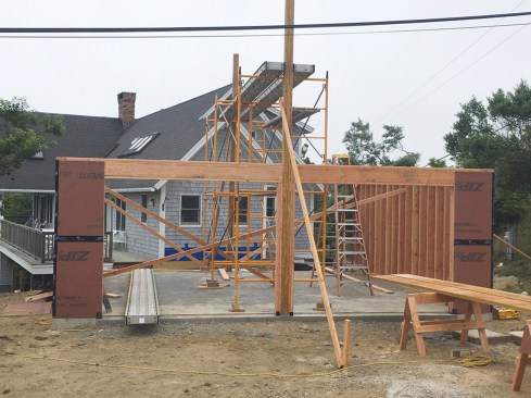

Straight is a relative quality control that is incorporated into every stage of the process. When laying out the plates, stretch your chalk lines very tight. Select the best material for your longest sill and wall plates, and the straightest studs for your corners. And before you start building the second floor or the roof on top of your new walls, use string lines and braces to hold them perfectly straight.
With the walls framed and braced so that the top plates are straight, the project can move onto the next phase: roof framing.
Don’t trust short walls to stand perfectly plumb—check and brace them. You can tack the sheathing temporarily and nail it off after the wall is braced plumb. Long walls that are going to support opposing rafters should be braced with a slight bow inward in the middle (1/8 to 1/4 inch, depending on length, height, and pitch). The rafters will inevitably push them outward slightly as the building settles. Finally, don’t tighten anchor bolt nuts completely until everything is nailed together and checked for plumb.
