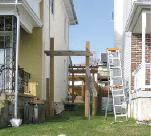

Our house has a side yard whose main feature used to be that it didn’t have any nice features (Figure 1). This tiny, unattractive bit of lawn tended to collect stuff, including, among other items, an HVAC unit, a radon fan, trash cans, and bikes. Tempting as it was to just fence in the debris and hide it from view, doing so risked accumulating even more junk. A better idea was to make the area attractive enough that we’d want to keep it neat.

We came up with a drawing expressing our overall vision, then moved on to what we call “full-size templating” (Figure 2) to match reality with imagination.
Figure 2. Full-size mockups of the girder and other parts were used to verify that the proportions looked right.

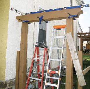

Rafter tails provide almost limitless opportunities for detail, but in this case we felt simple was better. Since there was a pre-existing pergola in the backyard with a basic circle detail on its rafter tails, we reflected that in the new structure. To get the assembly to “blossom” like the roof of a pagoda does, we made the girder extend as far as possible beyond the gate posts, stopping it 11″2 inches short of the property line. To make things easier – and so we could see any mistakes – we cut a test girder from 2×8 SPF. We put it in place, registered it 1″2 inch off the house, and double-checked its location 1 1″2 inches back from the fence edge using a 6-foot level. Sure that it fit left and right, we stepped back and inspected it to determine the best clearance height. That turned out to be 96 inches to the bottom of the girder – fully 16 inches taller than an interior door, which had been our original plan. While the test piece was in place, we marked its height on the posts. We also tested different length rafters, purlins, and stays. We decided that 30-inch-long 2×6 rafters crossing the girder looked best (Figure 6). We made three test rafters, and based on how they looked spaced evenly across the girder, decided on five rafters for the finished project. Atop the rafters, we ran 2×4 purlins that start 1″2 inch off the house and project plumb with the exterior edge of the fence. This is just 1 1″2 inches farther than the girder projects – not much, but it looks right. Forty-inch-long, 13″4-inch-wide stays cross the purlins and carry the design skyward.

Once we knew which size test pieces worked, we marked one item from each assembly and set it aside. With all the height and sizing (or “massing”) determined, we marked the posts and cut them to height – 2 inches lower than the top of the girder (more on this later) – using an 81″4-inch wormdrive saw (see Tool Kit, November 2010; deckmagazine.com).

The beauty of using test pieces and marking them in place on the posts is we could then use the test pieces as patterns – no measuring. We lined up the first side of the girder on the pencil marks we’d made on the post and secured it with two deck screws, fastening them top left and bottom right (more on this later). We then clamped the second girder to the back of the gate posts and checked the tops of the girders for level in both directions before fastening, again with two deck screws, top left and bottom right. Each element builds on the next. We placed the two outside rafters based on what looked right to us. That turned out to be above the outside faces of the gate posts. Next we measured the centerline between them and placed a rafter there. Left and right of the center rafter, we split each space and placed rafters on those centerlines, for a total of five rafters. We projected the purlins just past the girder, as described above, then positioned them on the rafters based on what looked proportional – in this case, 3 1″2 inches in from the outside edge of the rafters. Stays were centered between the rafters, atop the purlins. This didn’t work out perfectly. You can’t tell from the ground, but there are up to 1″2-inch variances in the spacing because wood’s not perfect and working off ladders doesn’t make for the greatest accuracy. If you want furniture-grade work, build it on the ground and install it in one piece. We fastened all the pieces in place with deck screws, except for the girder-to-post connection, for which deck screws served only as temporary fasteners. Through bolts would have made a solid connection between the posts and the girder, but through bolts presented aesthetic issues – you have to counterbore for the bolt heads for a plush look and cut the ends of the bolts off flush with their nuts using an angle grinder, exposing ungalvanized steel. Instead, we used 6-inch ceramic-coated washer-head “construction lags” we got at Lowe’s (Figure 7). They cost about a buck apiece, and they locked the assembly together tight – there’s 4 1″2 inches of steel buried in a 6×6, four times per post. Instead of drilling pilot holes for the construction lags, we simply removed the deck screws used to temporarily set the girders. Because they were set top-left, bottom-right from opposing sides, there was an offset that kept the lags on opposite sides from hitting each other.

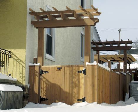

Fence and Gate Detail
We face-mounted rails and a top cap to the corner and gate posts, then hung the gate directly on the gate posts, insetting it slightly. A cane bolt holds one gate fixed (Figure 9).
Figure 9. A cane bolt engages a pipe driven into the ground to secure the fixed half of the gate.
Twelve inches of 3″4-inch iron pipe hammered into the ground receives the bolt and makes for a dependably stationary gate panel. A hardware-store gate latch enables the working side to move and latch freely while a 1-by stop (or astragal) enables the working gate to close over the fixed gate and hide the gap (Figure 10).
Figure 10. A standard gate latch holds the active side of the gate closed.
