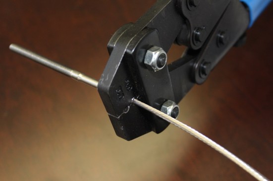

There are a variety of low cost crimping tools and smaller swaging tools meant for field installing cable fittings. Crimpers (which look a lot like a pair of bolt cutters) basically smash the fitting on to the cable with manual force, so multiple crimps are often necessary to achieve the proper connection. Hardware manufacturers call out specifications for the desired diameter of a crimp so that the installer knows they are getting the right amount of clamping force.

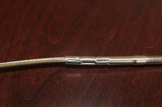

Field-swaged fittings are widely available and relatively inexpensive, but the crimp marks are noticeable and the fittings are susceptible to corrosion where the metal has been marred by the crimping tool.

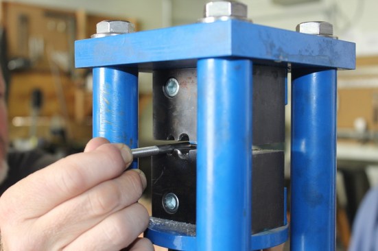

A true machine swage is created in a shop by a manufacturer or fabricator using either a rolling swagger or a press swagger (shown here). The process of swaging cold-forms the fitting around the cable using extreme force, resulting in a connection that should equal or exceed the breaking strength of the cable.

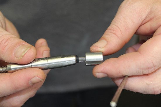

As the industry matured and the internet improved, the technology and the demand for cable railing systems changed dramatically. Today the cable-railing market is much larger, and the variety and availability of hardware have exploded, even while the cost of some stainless cable has dropped significantly compared with 10 years ago. One of the biggest changes has been the introduction and evolution of swageless fittings, which don’t require any type of crimping or swaging. Instead, swageless fittings utilize a small, one-way locking mechanism that allows the cable to enter in one direction while grabbing the cable if pulled in the other direction.

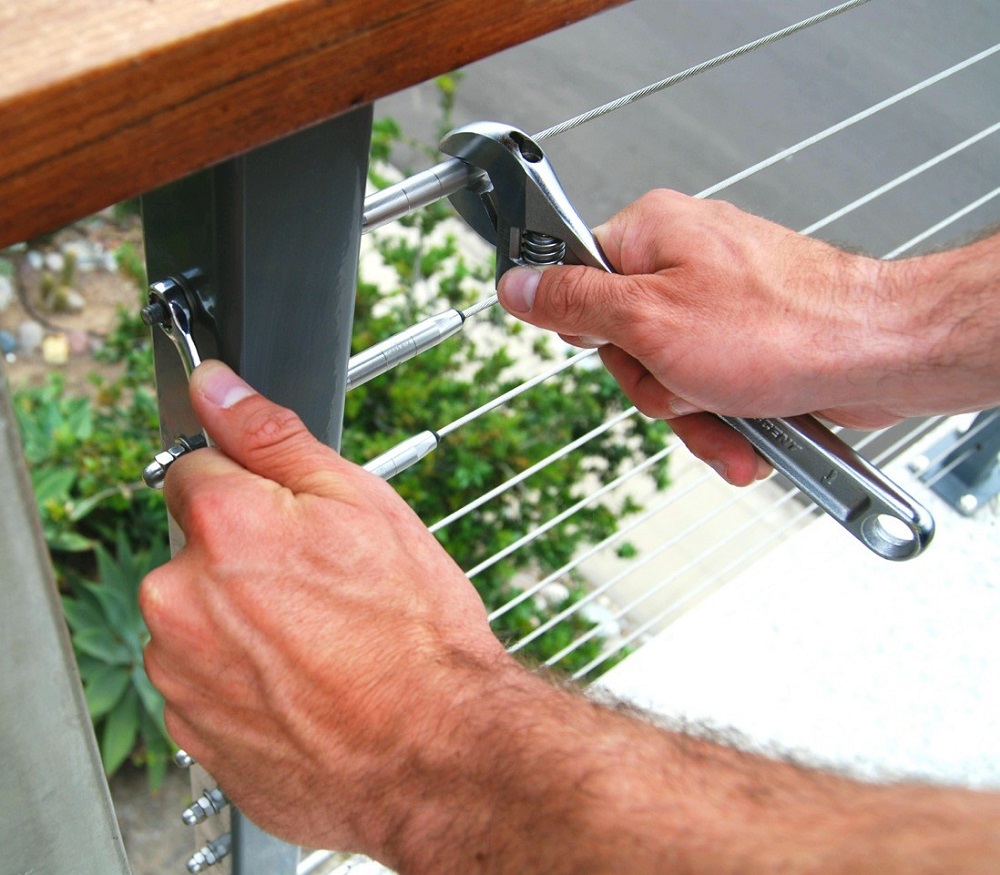

Between the DIY movement and the advent of swageless fittings, we don’t see too much hand-crimping done these days. In fact, it has been years since we have actually crimped a cable fitting. I realize there are still quite a few installers who field-crimp fittings, but for our company, the only possible benefits would be cost savings or availability. Convenience almost always comes at a price, and swageless fittings are no exception; they carry a premium. However, for our company, the speed of installation, lack of need for special tools, and the slick appearance of these fittings largely outweigh the cost factor.
Not only are swageless fittings easy to install for both pros and first-timers, they can also be disassembled with the help of a special tool that releases the cable from the locking mechanism inside the fitting.

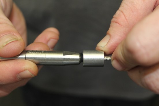

Swageless fittings utilize a small one-way locking mechanism that allows the cable to enter in one direction while grabbing the cable if pulled in the other direction. This technology is at times compared to a compression fitting. Reputable manufacturers of swageless fittings also test these mechanisms to achieve the breaking strength of the cable. Swageless fittings can be released with the use of another tool that depresses the mechanism and allows the cable to be released.
San Diego Cable Railings Not only are swageless fittings easy to install for both pros and first-timers, they can also be disassembled with the help of a special tool that releases the cable from the locking mechanism inside the fitting.
