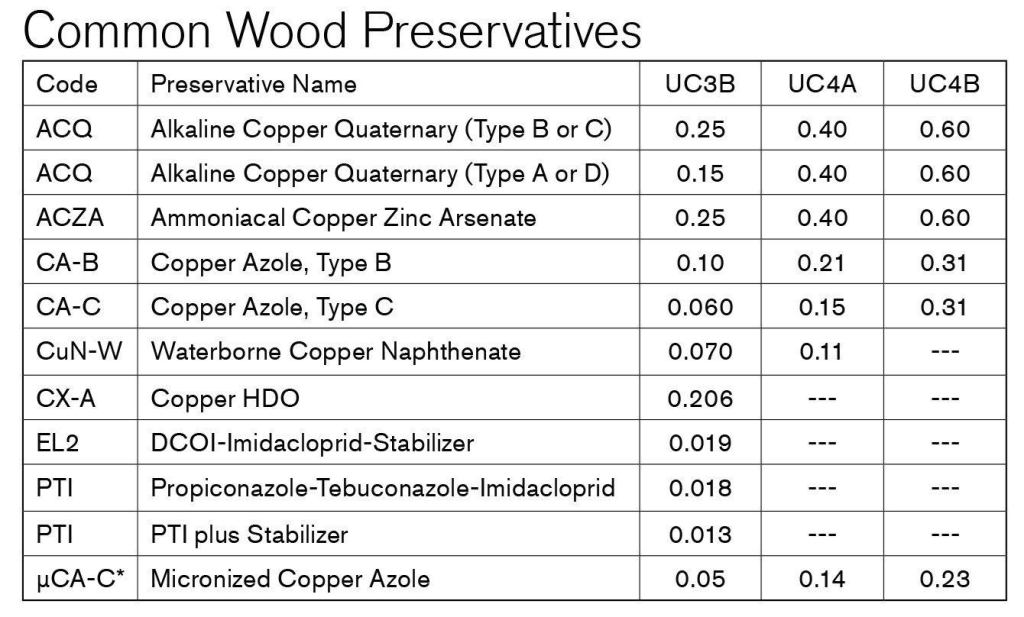

For ground-contact use, CA-C is the most widely-used AWPA treatment. Most East Coast treaters have phased out ACQ, though it’s still popular with Western treaters working with Douglas fir. Micronized copper azole—sometimes referred to as MCA—is widely used, but not standardized by AWPA.

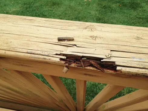

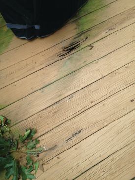

When chromated copper arsenate (CCA) was withdrawn from the residential market in 2003, the chemical industry responded by introducing wood-treating formulas that still contained copper, but that replaced the arsenic and chromium with other, less-harmful active ingredients. These formulas have now had more than 10 years to prove themselves in the U.S. market—time enough for suppliers and builders to assess the performance of lumber treated with them. The good news? It performs pretty well, both in long-term scientific tests and on decks in the field. The bad news? There have been a few complaints and reported failures. Some users have reported premature decay, particularly in severe exposures or in ground-contact situations.
According to some in the industry, the reported performance issues don’t reflect a problem with the new formulas, which have all passed a long gauntlet of testing designed to establish their efficacy. Instead, the problem is one of “misapplication” by end users: Lumber that’s treated—and only rated for—above-ground use is being put into contact with the ground. But at least one wood treater thinks the industry should make sure this can’t happen—by treating most lumber to ground-contact retention levels, as was done with CCA.

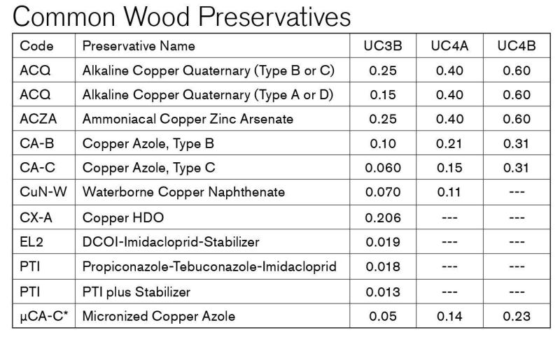

Main ingredients. Generally speaking, treated-wood formulas have four main elements. There’s a carrier—the fluid used to get the active ingredients into the wood. There’s a primary active ingredient (generally copper, which is deadly to most fungi and wood-eating insects). There’s a “co-biocide” or two—additional active ingredients designed to kill copper-resistant fungi. And finally, there’s a fixative, included in the mix because it helps bind the other ingredients into the wood so they won’t leach out if the structure gets wet.
In the old CCA, copper was the primary biocide; arsenic was the highly effective back-up bug and fungus killer; and chromium, besides being deadly to bugs and fungi, was the fixative that locked the copper and arsenic into the wood’s molecular structure.
With a few exceptions, the new treatments still use copper as the big gun. But the secondary biocide can’t be arsenic any more. Instead, some formulas use “azoles,” complex carbon-based molecules that have been around a long time and are well-known in agriculture, where they are sprayed on fruit and vegetable crops to combat fungi. Other formulas use a “quaternary” compound (“quat” for short), which is basically a strong soap or detergent. Quat, like azole, is a well-known agricultural pesticide; but in wood treating, quat also acts as a binder, helping to lock the other chemicals into the molecular matrix of the wood cell walls, and as a soapy surfactant that helps the copper penetrate the wood.
Dissolved or micronized? To complicate matters further, there are two ways of preparing the main-line copper ingredient and forcing it into the wood. One class of formulas uses copper dissolved in an alkaline solution of water (that list includes Viance’s Preserve and Preserve CA, as well as Koppers’ NatureWood ACQ and NatureWood CA and one version of Lonza’s Wolmanized Outdoor wood). The other approach, typified by Koppers’ MicroPro/LifeWood and by most of Lonza’s Wolmanized wood, uses “micronized” copper—solid copper that is ground into very small granules, and suspended, not dissolved, in the water-based carrier fluid (Figure 4).
Micronized treatments use less total copper and a less corrosive carrier. The ground-up copper bits sit in the wood and slowly release their copper into it, helping to extend the treatment’s effective life. Micronized treatments have taken over the bulk of the market, especially for easy-to-treat southern yellow pine lumber. But dissolved formulas are still important, particularly on the West Coast and in Canada, where much of the commonly available Douglas fir, spruce, hemlock, and western pine lumber is harder to treat and won’t absorb micronized copper. Dissolved formulas are also used to treat eastern hemlock, another hard-to-penetrate wood, for use as landscape ties. (You’ll know if you’re looking at one of those “refractory” species, by the way, because you’ll see telltale razor marks where the wood has been incised to allow deeper penetration of treating chemicals and to help limit cracking of the wood after treatment.)
Carbon-based options. Koppers, Viance, and Lonza all offer wood treated with non-copper preservatives, too. Agricultural pesticides like imidacloprid and tebuconazole don’t lock into the wood fibers as readily as copper, however, so products that use it, like EcoLife II, EraWood, and NexWood, are limited to above-ground use.
If you’re buying treated wood off the shelf, and if you’re not looking too closely at the label, you might be getting dissolved copper with quat, dissolved copper with azole, micronized copper with quat, micronized copper with azole, or—in the case of Lonza’s new “BARamine” Wolmanized wood—either dissolved or micronized copper with two kinds of azole plus quat: the whole candy store in one bag. As for the wood, if you’re building in the eastern U.S., the treated wood is probably southern yellow pine (SYP), but if you’re building out West, the lumber could be any of a half-dozen different conifers.

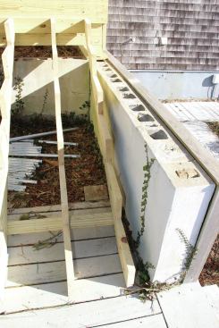

So … does it work? That’s the question the building code asks, too—and to get code recognition, treated-wood makers have to demonstrate that the answer is yes.
There are two ways that a method for pressure-treating lumber can be accepted by the building code. One way is to pass a whole battery of tests developed by the American Wood Protection Association (AWPA); the other is to run a similar gauntlet called an “Acceptance Criteria,” established by the International Code Council (ICC) with compliance verified by the council’s Evaluation Service, ICC-ES. The ICC-ES process requires tests to be performed by accredited third-party laboratories, while the AWPA lets applicants do their own qualification testing in-house. But the AWPA process is no rubber stamp: Applicants need to win a two-thirds vote of approval from the AWPA membership, which includes their competitors. In the ICC-ES process, the standards are approved by a nine-member committee of state and local building officials (competitors can’t vote, but they can speak at the hearings).
Under either regime, AWPA or ICC-ES, a proposed treating method needs to perform acceptably in laboratory testing as well as in an outdoor, years-long field exposure called a “stake test.” The lab testing is unrealistically harsh on the wood: Pieces of wood are placed directly in contact with moist soil that is inoculated with wood-destroying fungi and maintained at the ideal growing conditions for the rot to take hold. Samples are also subjected to “forced feeding” challenges in containers full of termites. But the outdoor stake test is the high hurdle in terms of time, as well as money; stakes pounded into the ground in the woods or jungle must hold up for at least three years, and usually for longer, in the most severe tropical exposures.
Formulas on the market today have all been through seven or more years of stake testing in warm, moist environments like Florida, Mississippi, Hawaii, New Zealand, and Indonesia. Generally, the stake test results show that every formula on the market today—alkaline copper quaternary, copper azole, micronized copper quaternary, and micronized copper azole—holds up well enough to get approved by the code. The stake tests also illustrate the importance of chemical treatment levels. Typically, stakes treated with high concentrations of chemical tend to hold up indefinitely, while stakes treated with lesser levels begin to slowly deteriorate after a few years in service.
Mileage may vary. The test conditions are certainly tougher than what a typical deck experiences—test sites are chosen because they have active fungi and foraging termites in the soil, and untreated “control” stakes typically crumble into the dirt in a matter of months.
On the other hand, the treated test stakes aren’t representative of the treated wood product you’re likely to find at the lumberyard. Typically, stakes for the tests are made with southern yellow pine, a species that readily accepts treatment. At the lumberyard, at least in the western U.S., you’ll find other, harder-to-treat wood that might not be fully penetrated with chemicals. And test stakes are all sawn from sapwood, the newer-growth wood from the outer rings of a tree. Heartwood from the center of any log, including southern yellow pine, is resistant to penetration by chemicals. Treated wood standards allow heartwood to be in the board, and they don’t require the heartwood to contain any treating chemicals.
Just as the wood in the stake tests is different from typical treated lumber, so also are the chemical treatment levels. When stakes are treated for a stake test, they’re checked to make sure that they’ve been fully treated to the intended retention level. But in actual lumber, only 85% of the sapwood is required to be treated. And given the natural variability of wood, that means not every stick you buy gets the exact concentration of chemical that’s listed on the label.

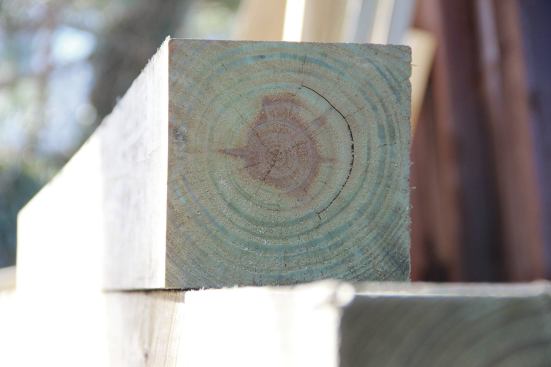

Variability in the treating process is a real problem. Lumber is treated from the outside in. To get the chemicals into the wood, treaters roll small rail-car loads of lumber into big vats, fill the vats with treating solution, seal the vats, and create a vacuum to draw moisture and air out of the wood. Then the vacuum is released and pressure is applied, and the chemicals in the vat are forced into the wood. In practice, this means that outer parts of the wood get more chemical than inner parts. And other factors, including wood moisture content, grain direction, and wood density, also affect the uptake and retention of the treating chemicals—so even on the edge of the board, the treating may not be uniform.
Treating companies and third-party quality-control verifiers check to make sure that wood coming out of the treating vats has reached the specified level of treatment—on average. But treaters check their loads of treated wood by drilling out multiple samples, grinding the samples up, mixing the samples, and testing the mixed samples all at once for chemical content. That’s efficient, but it doesn’t pick up on any variability in the treated load. And in reality, loads can vary a lot. If a load of lumber is sampled in 20 spots and the samples are mixed and tested, the load may average out at the required retention, but typically, some parts of some boards may have double the required treatment level, while other spots may have only half—and even if that’s the case, the whole car-full passes the test.

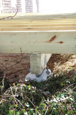

You don’t know which part of which stick has been treated to above-average or below-average levels. But you do know that heartwood is resistant to treatment, so avoid putting exposed heartwood into a wet or dirty situation. You also know that the outer part of the wood has likely received more chemical than the inner part. So if you cut the wood, always treat the exposed cut by soaking it well with a 2% copper naphthenate solution (easy to buy in cans at any lumberyard). If you cut out a stair stringer, treat the cuts. If you cut the end of a post, treat the cut end. If you notch out a deck post to make a seat for a girder, treat the notch.
And while you know that retentions in a clip of wood may vary from the average in one spot or another, you also know that lumber that’s rated for ground contact has a higher average retention than lumber that’s rated for above-ground use only. So if you’re placing wood into service in a tough situation, it’s a safer bet to get lumber that’s rated to ground contact—even if that requires you to pay more and wait for delivery.
