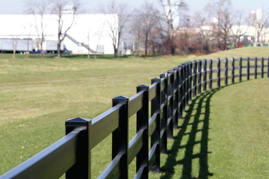

Not all vinyl fences are created equal, and professional fence builders thumb their noses at much of what’s sold by big home centers—vinyl sleeves that slip over pressure-treated wood fence posts, and fence sections hung on metal brackets that are screwed through the vinyl to the post—describing them as DIY products of inferior quality.
One problem with DIY-grade fences is that they tend to be made of relatively thin and brittle plastic—that’s why the structural wood posts are needed. To demonstrate the difference, Yocum sometimes gives undecided customers a sample of the cheaper product, along with a piece of his high-end fencing, Certainteed’s Bufftech. He tells them to go home and cut both before making a choice. “The better product will go to dust, while the cheaper one will shatter into chips.”
Another drawback to bracketed fencing, says Yocum, is that it needs to step up a hill, rather than follow the slope of the land, as some customers prefer. That’s because the 90° brackets can’t be installed on an angle

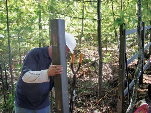

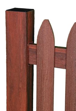

By contrast, most of the vinyl fencing that the pros use has rout-and-lock connections: Rails slip into pre-cut openings in the posts and are secured inside of the posts. The system ensures that rails lock into place while also giving them room to expand and contract with changes in temperature. The vinyl posts are thick enough to be structural, and bottom rails are reinforced with steel to make fence panels more rigid
Unlike with wood posts that can be trimmed in place, there’s no room for adjustment once a vinyl post has been cemented in its hole. The slots are pre-cut into the posts, so the posts must be installed at the exact finished height.
Because of the thicker material used in rout-and-lock fence systems and the fact that structural integrity doesn’t depend on brackets, longer spans between posts are possible—8 or 10 feet versus 6 feet for most bracketed systems. Rout-and-lock fences are also more resistant to wind. For even better wind resistance, you can buy aluminum stiffeners to drop into the posts. When installed correctly and with approved stiffeners, some reinforced vinyl fencing can even meet Miami Dade County, Fla., wind requirements, the toughest in the nation. The stiffeners are also used to reinforce gate posts.

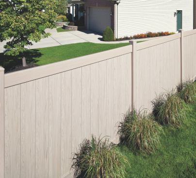

n addition to low maintenance, another reason vinyl fence has become so popular is the growing array of colors and textures that are now available. Once upon a time, the only choice was a white fence with a smooth and shiny surface. A few years ago, manufacturers started adding a limited number of color options, such as light tan and clay tones, but anything darker tended to have problems with chalking and excessive expansion. Today, improved vinyl formulations allow for dark brown and even black fencing that manufacturers claim will perform well in most environments. And with improved manufacturing technologies, wood-grain patterns can be cost-effectively embossed on vinyl to provide the surface with more natural-looking color variegation.
In fact, these improvements in color technology have changed the way fence parts are made. Early products were monolithic—the vinyl was extruded in a single layer. Now, most are co-extruded: A thick inside layer and a thin outside layer are extruded at the same time and joined under heat and pressure to form a molecular bond. The outside layer, or capstock, contains the color and the UV inhibitors. The use of acrylic colors in the exterior layer of some products makes them less prone to fading than standard PVC. Some companies even extend their 30-year warranty to color retention.

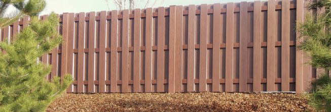

Composite and Cellular PVC Fencing
Wood-plastic composite and cellular-PVC fences have solid pickets and rails, and sleeves designed to go over treated 4×4 posts.

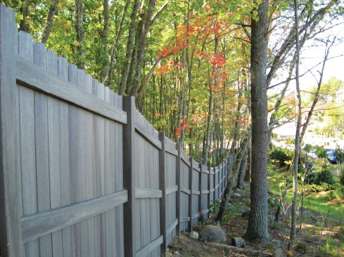

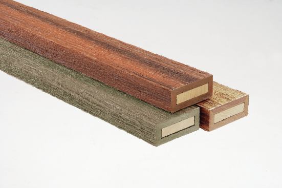

Composite fencing is made from the same material as composite decking. Indeed, the two major players, Fiberon and MoistureShield, are primarily decking manufacturers. While MoistureShield makes pickets only (to fasten to wood posts and rails), Fiberon makes an entire system, with posts and rails made from Port Orford cedar covered by thin composite sleeves. A rout-and-lock system secures the rails to the posts.

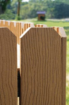

One Fiberon representative I spoke with recommended that the company’s composite pickets be fastened to rails with staples. He cautioned against using screws, because the composite expands and contracts more with temperature changes than does wood. Of course screws are acceptable on composite deck boards, but those boards usually sit on joists spaced every 16 inches, whereas the pickets span 2 feet between horizontal rails, making the unsupported span more likely to bow and bend if the connections are too tight. Staples, which are thin and flexible, can move with the boards. Installers who prefer to use screws can compensate by over-drilling the screw holes—that is, drilling a 1/2-inch-diameter hole for a 1/4-inch-shank screw.
Besides its cost, a drawback of composite fencing is that it’s quite heavy, with a 6-foot-long section weighing about as much as an 8-foot section of pressure-treated fencing. To reduce weight, some manufacturers have experimented with foam-filled pickets. While this technique can lighten the load by about 30%, it hasn’t been widely adopted because it significantly compromises the rigidity of the pickets.

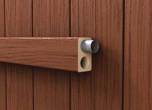

Another weight-saving alternative is to make fence components from cellular PVC. Enduris claims that its Endwood PVC fencing is 30% to 40% lighter than comparable wood-plastic-composite fencing. To improve long-term color retention, Enduris wraps its PVC fence components with an acrylic capstock. Its rails are extruded with a pair of voids that can be reinforced with steel tubing to reduce sagging. The company recommends ring-shank nails for attaching pickets to rails.
