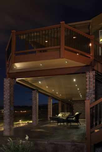

Low-voltage lighting isn’t just post caps. A wide variety of fixtures provide general, decorative, accent, and safety lighting.

Lighting for Tasks, Safety, and Decoration
You can use light several ways. Spotlights and hanging fixtures are just the ticket for task lighting that illuminates a specific area — say for grilling or for reading (Figure 1). Safety lighting is used on stairs, transitions, and spas (Figure 2). Mini recessed lights that fit into holes drilled along stairs are another option. Lighting these areas also accentuates them, but true accent lighting focuses on a feature, such as a tree or mural (Figure 3).
