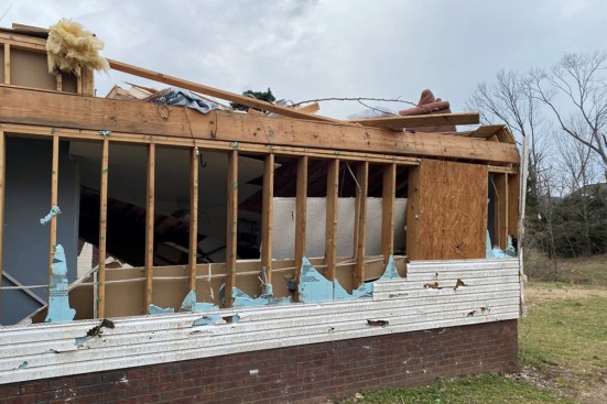

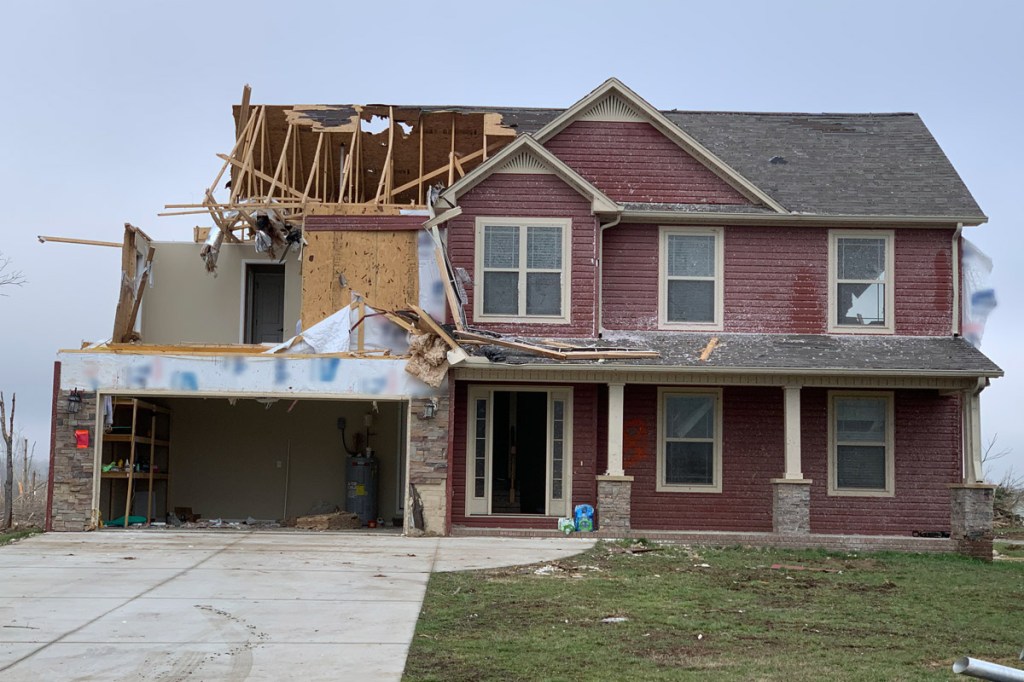

There is a common myth that all tornadoes are so strong that structural failure is inevitable, no matter how well a building is constructed. But in fact, weaker tornadoes rated as EF-0, EF-1 or EF-2 by the National Weather Service comprise 95% of all tornadoes. A home that is carefully constructed, in accordance with current building codes, can withstand these smaller, less violent storms. Implementing these nine tips in the design and construction of residential structures can help prevent damages caused by high wind events. More on resilient construction.

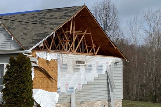

2. Gable-End Bracing
One of the weakest links in residential structures during high wind events is the connection between the gable end and the wall below. Tie gable-end walls back to the structure.

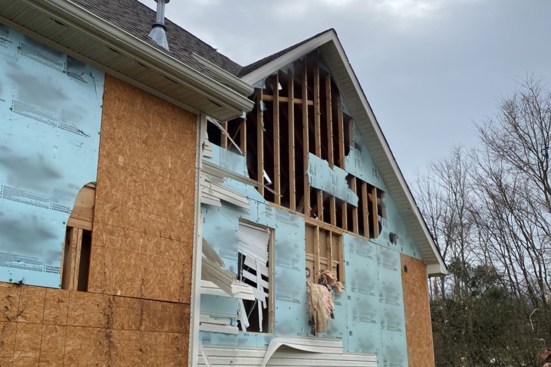

3. Gable-End Wall Sheathing
Gable-end wall failures are frequently observed in tornado events when non-structural sheathing is used. Sheath gable-end walls with wood structural panels, such as plywood or oriented strand board (OSB).

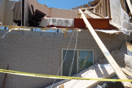

5. Connection Between Stories
The most effective way to provide lateral and uplift load continuity is to attach adjacent wall sheathing panels to common framing. Nail upper-story sheathing and lower-story sheathing into common wood structural panel Rim Board.

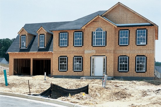

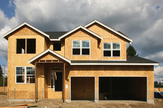

7. Continuous Wood Sheathing
Continuously sheathe all walls with wood structural panels including areas around openings for windows and doors. Nine more reasons to build with fully sheathed wood walls.
