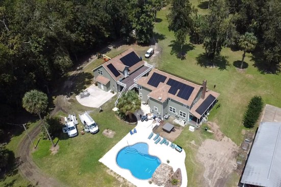

The solar-and-battery system at the home of Patrick Altier’s client is a model for resilient energy planning.
At the home north of Ocala, Florida, Solar Trek installed enough solar photovoltaic panels and battery energy storage to power the whole home, including multiple air conditioners and a charging station for two Teslas. But while the batteries are enough to power the home for about three days, Altier’s client wanted an extra insurance policy: a propane standby generator.
“The generator is that safety net” for when the sun isn’t shining, says Altier, owner and president of the central Florida company that installs solar electric systems and generators. “Let’s say there’s a storm and it hangs around longer than we anticipated. I can use that generator to charge the batteries or run the house. We’ve got several customers that fall into that group where they are concerned about long-term power.”
With battery energy storage systems becoming more popular as a way to convert clean solar power to protection against grid outages, Altier and Solar Trek have become adept at discussing the pros and cons of batteries and standby generators fueled by propane or natural gas. And in recent years, new inverter technology has enabled systems that combine the best features of both.
For this project in southeast Ocala, Florida, Solar Trek installed a solar array and a propane-fueled standby generator to keep the home powered when the solar panels are unable to operate.
