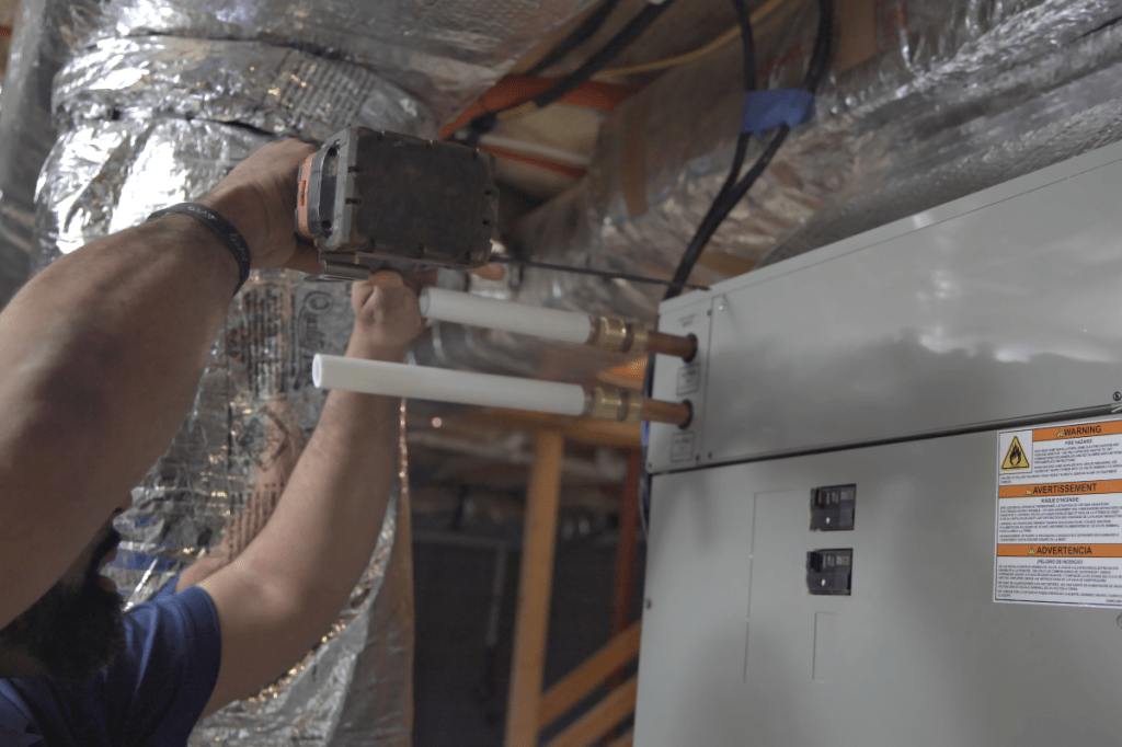

Hydronic Heat Pump Solutions
The hybrid hydronic heat pump solutions, such as the Heat Pump Helper and the Heat Pump Companion, are other options offering an innovative approach to home heating. This set-up integrates a propane tankless water heater with a home’s existing air-source heat pump system. When outdoor temperatures fall below 40°F, the system activates the propane-powered water heater to circulate hot water through a hydronic coil within the air handler. This process delivers warm air through the home’s ductwork, providing efficient and comfortable heating without relying on electric resistance heat strips. By utilizing propane in colder conditions, homeowners can achieve up to 35 percent savings on heating costs compared to all-electric systems, while also benefiting from improved performance and reduced electrical load demands.
