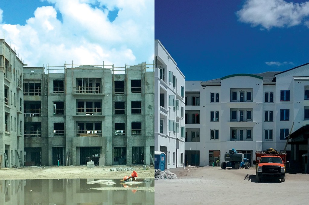

As proof, experts say water damage at the construction site is the second leading cause of loss. One prominent insurer pegs water losses for about 13% of all construction insurance claims. The average claim? A margin-wrecking $140,000.
Water is the natural enemy of construction. Excessive moisture risks debris removal, lost workdays, rework, property and materials damage, not to mention a water-drenched reputation.
Your project may not require a sophisticated dewatering strategy with pumping solutions. But it does deserve your best effort to keep moisture at bay. Here are seven ideas to consider for your next project:
