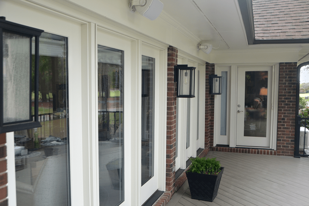

Door frames such as FusionFrame from Endura Products—with a wood core, composite bottom, and composite exterior—eliminate these installation problems. “FusionFrame is a good fit for us because it installs just like a wood jamb, but it doesn’t have the paint issues or the possible issues that finger-jointed primed frames have,” Bohmbach says. “I can’t say if it’s in exaggeration or not, but I can say that I’ve been told it can save hours off an installation versus full composite. And I’ve also been told that it can save 30 minutes, maybe even an hour, on a bigger door unit versus just a normal wood frame.” That’s because you don’t have to spend time on filling holes, lightly sanding them, and touching them up with paint, he says.
Many all-composite wood frames also claim to be prefinished, but they require fasteners that puncture the exterior surface. “It’s not aesthetically great, and every time you puncture a painted or stained finish, if it’s not filled perfectly, you’re going to have the chance of getting water infiltration into those points,” Bohmbach says. “FusionFrame makes for a really nice, finished look because you’re not driving fasteners through the exposed wood,” Bohmbach says. Its design allows you to remove the cover, screw everything down where it can’t be seen, then add the cover so you can’t see the fasteners.
Still, moisture and rotting remain a threat, especially at the bottom of the frame. “Almost anytime you have a door unit failing specifically from rotting, it’s because the water has wicked up through the frame,” Bohmbach says. FusionFrame’s composite bottom helps alleviate the issue.
