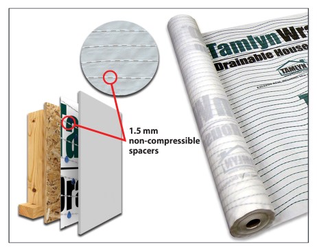

  5. Sharpest ax. Building product technology is always changing. Take drainable wraps and rainscreens, Robinson says. “The outside and inside walls used to have an open cavity. Moisture that got in there could get out. Things could dry. There needs to be a capillary break,” he says. He cites TamylnWrap Drainable Wrap as a great way to ensure that capillary break without compromising fast and easy installation. A patented gap design in combination with a 19 perm rating allows TamlynWrap to work wonders on eliminating mold, rot, and other water damage.
