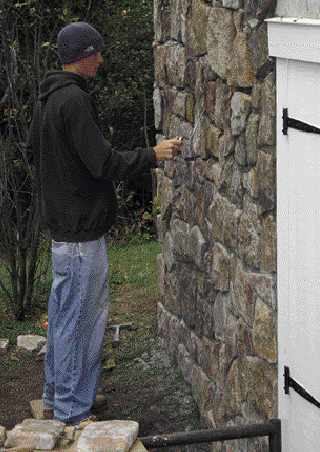

To eliminate trapped air, we troweled mortar directly onto the wall and completely back-buttered every stone, pressing each firmly against the wall to force out excess mortar. Occasional removal of a just-set piece assured us that we were getting a solid bond.
We installed the stone working horizontally from the bottom up, so that each successive course would be supported by those below. We jointed the stones as we went along, using a tuck pointer, then brushed the face clean of excess mortar. Tuck pointing after every few courses helped prevent the stone from slipping before the mortar set up (Figure 4).
